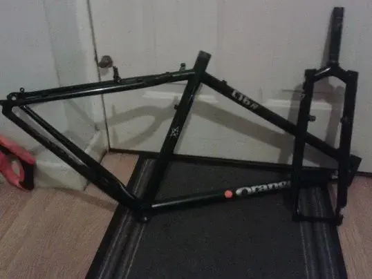

I put a stronglight triple chainset 28x38x48 with the 115mm recommended BB and the chainset is touching the chainstay. Anyone know why this is happening? Spa cycles assured me this was the right BB. I believe the chainset is for a road bike is that makes any diference. Bloody annoying!!!
