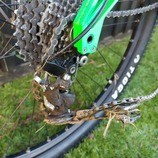

So my ride today became abruptly terminated by my rear mech disintegrating!

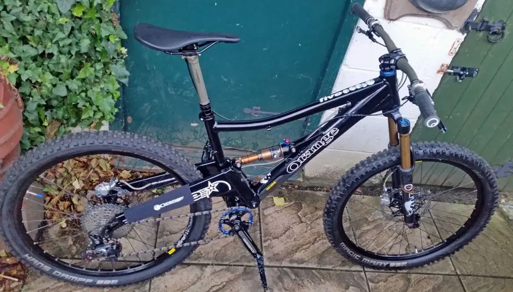

My conversion on my (now sold) 2013 5 was just 11 speed but it worked well. You should be able to keep cranks if you can achieve suitable chainline. Can't see why you couldn't. Best to go with a narrow wide chainring - maybe even try an oval!

Cranks you can simply bolt on a narrow wide ring in whatever bcd it needs. Or buy new cranks.
Shifter, mech and chain will need replacing of course.
Cassette might fit on your hubs, I'm not up with 12sp so can't say if one will simply bolt on. You might need a different freehub, XD driver or micro spline, or what you have might work.
If you use a clutch mech and narrow wide ring, you shouldn't need a chain guide.

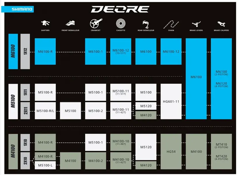

Not sure how fancy you want to go with the group but the latest Deore stuff is super flexible so might be ideal for what you want.
