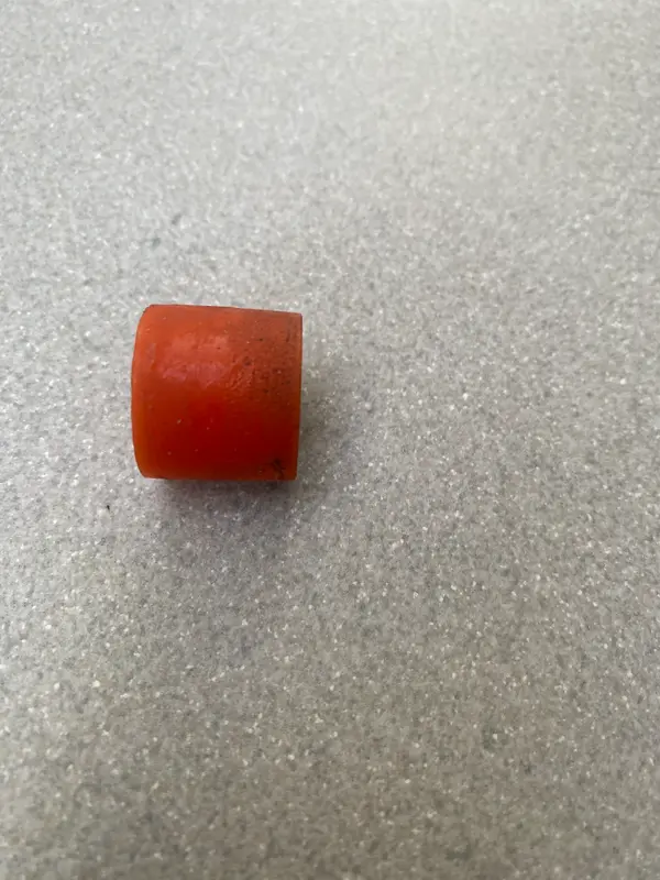

I just took my Manitou Amswer Mach 5 SX fork apart from my 96 Stumpy and was amazed to see the elastomers were pretty much all in pristine condition. The pink ones and blue ones were all great, the orange one was perfect...but the black one at the very bottom of the right hand fork leg was like chewing gum!
Does anyone by chance have one of these knocking about, it seems a bit mad to change all the elastomers and I can't see anyone who just sells single ones.
It is the same size as the orange one pictured

IMG_2033.webp , 20mm X 20mm with a 10mm hole.

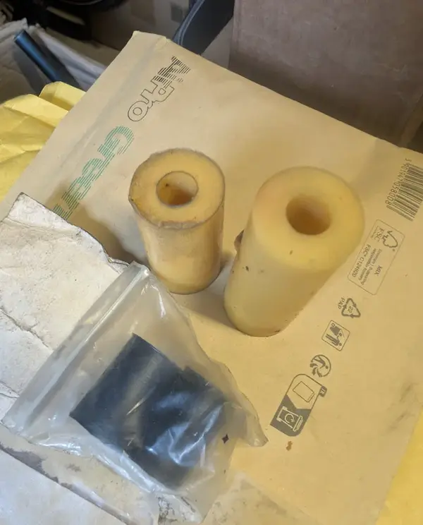

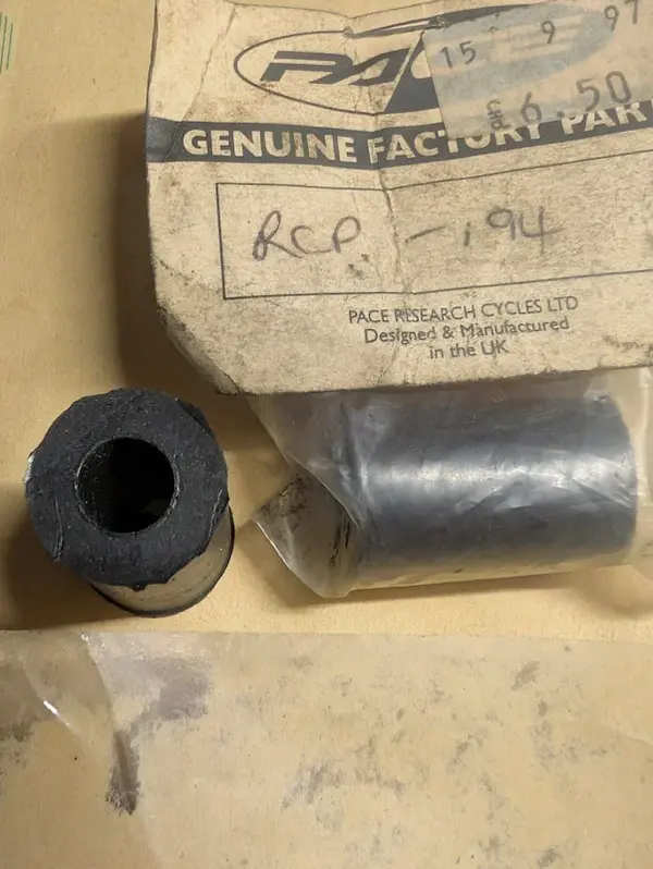

I have these. Pace are approx 28mm, the other 2 are 35mm and 45mm ISH. Pace ones are quite soft, the light coloured ones are much firmer.
You can cut them to size by putting a dowel in the hole to keep them solid.
