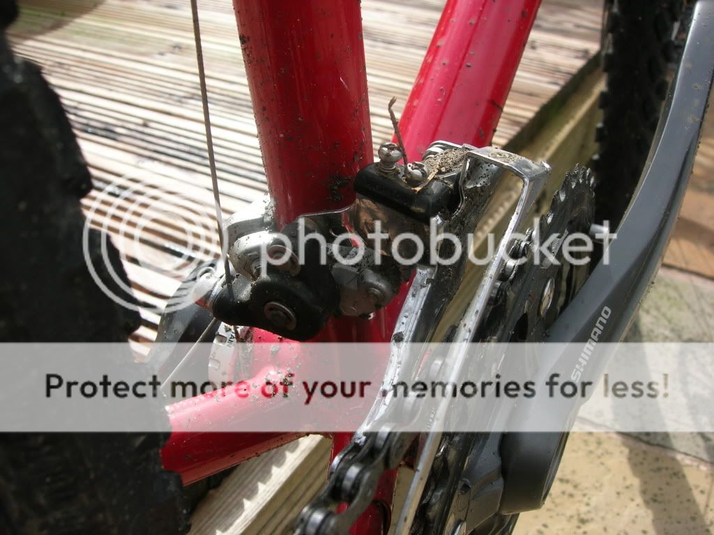

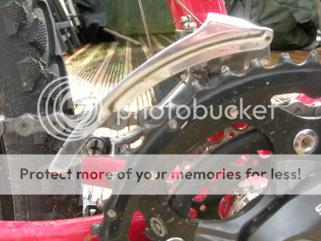

just a quick question - what front mech are people fitting to these?
i fit an old xt m750 and i'm struggling to get the front rings shifting right,i took it into the lbs and they told me the front mech was wrong and i should contact on one to find out the correct mech :?
i thought a front mech was a front mech,is he talking cobblers??

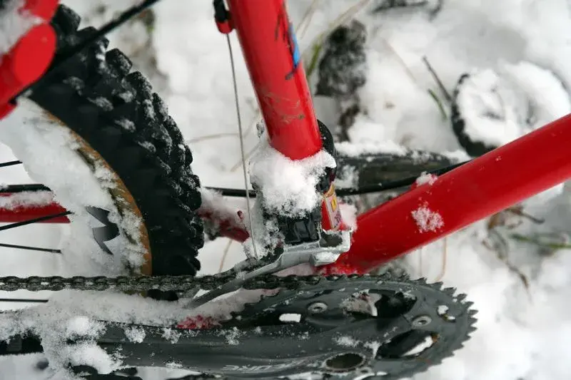

Not had any chain suck in the 500km or so it's done (mud, snow, and fairer conditions) - built up with shiny new 2012 Deore 3x10 if that makes a difference.
I'm running a bottom swing top pull m750 on mine and it's fine, what did LBS fella suggest?
how's the chainring clearance? as in, is there more than mine! :lol:

Have to go look at the weekend - only pictures I have are full of snow. :-)
righto,i've had a look and it appears to be top pull/top swing i think
it either moves over from middle to small or middle to big ring but won't do all 3.took it from my santa cruz where it worked no problem,fit it to this frame with a shim and it's not having any of it
any ideas please before the bike shop talk me into buying a new mech :?
