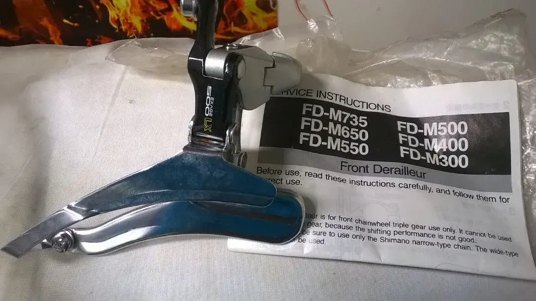

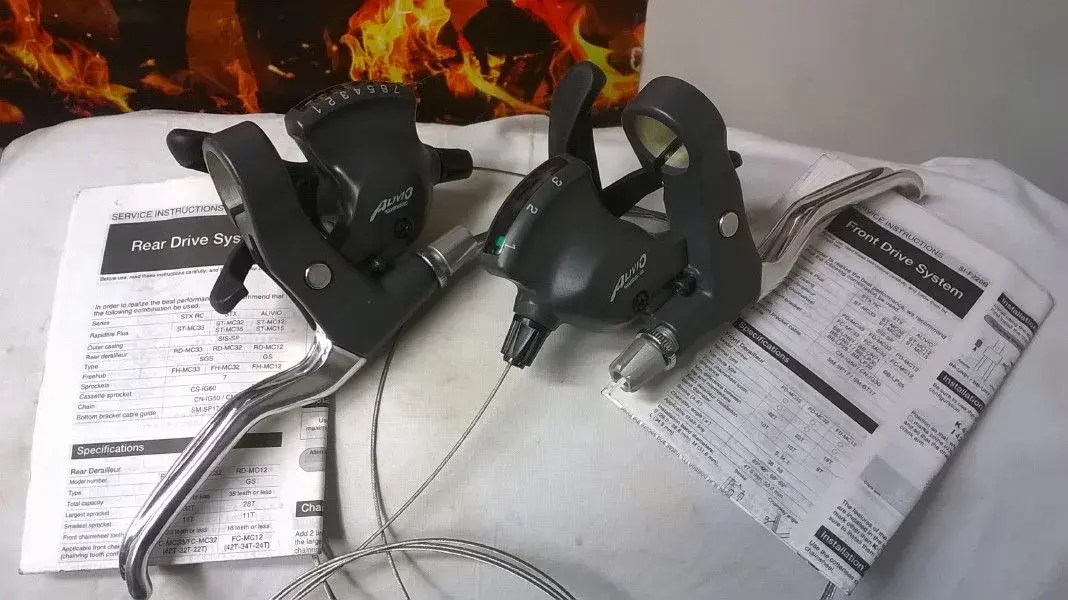

Got some NOS upgrade parts today from local store
Shifter/brakelevel combos Alivio MC12
Front Derauller Exage500LX
The shifters are a bit to new for the bikes (1995 production) but will do, the Front derauller is spot on, production 1990->1992

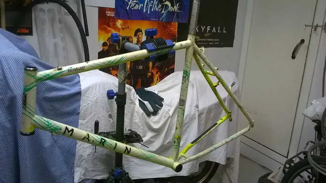

Re: Old MARIN Muirwoods mtb
Ok, some updates.

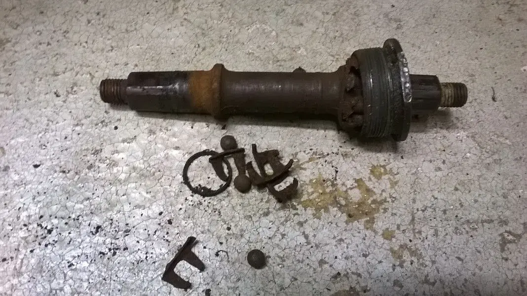

Fork and stem is off, headset is in good nick.

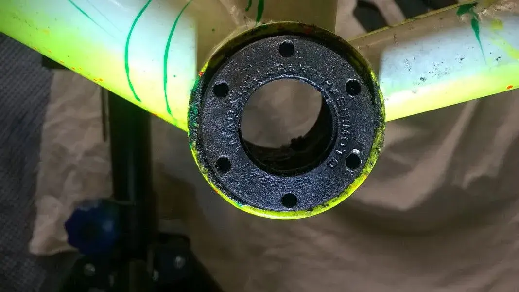

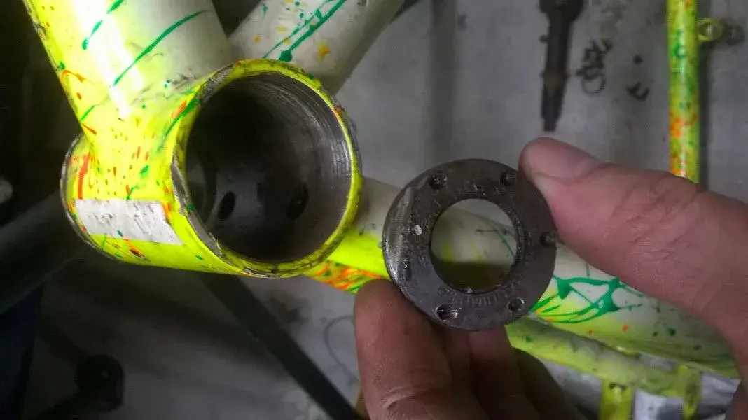

Also right side BB cup is off, came out nice after some heating whit a heat gun using the vise and human power , seem the BB has seen its best :lol:
The left side is still there
I see only to ways to go on, get/make a proper tool or the tempting one to grin down 2 flay parts as on the right side cup and take it out clamping the cup in the vise.
And the seatpost is still in :facepalm: given it WD-40 therapy so far, I guess heat is the anwser here also? Advise would be thankfull.

Ok, the other BB cup is out :D

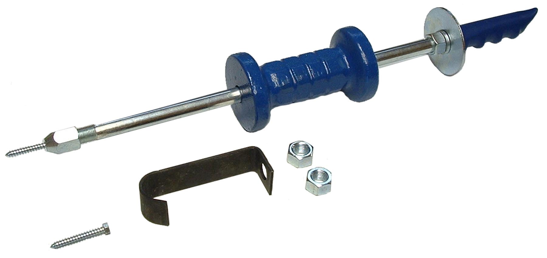

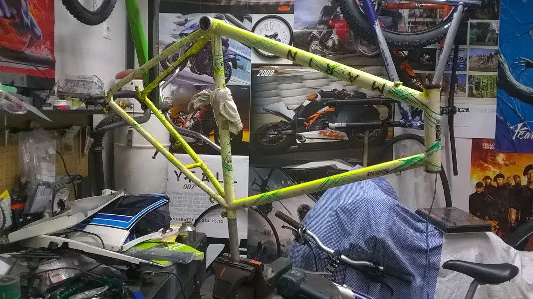

A small uppdate. Did try a different thing, a dent puller
did pull from the seatpost, having a set of old HT2 bearing cups in the BB to avoid stretching it oval whit a tire iron thro the BB cups and supported by my feet. The effect, well in 20 min the seat post came ~1,5mm out, and I got a sore hand.
I now have it in the vise upside down and the seat tube filled whit WD40 up to the bottlecage hole. I give it regulary heat treatment whit the heat gun to give movement so the ED40 hopfully will go in betwen the frame and seatpost. Have to work out a way I can use the dent puller the other way, having the frame hanging somewhere so I can use the gravity to use the dent puller and use heat the same time. Just need to find out how to hang the frame to do it....
So far so good, but any attempts to get the seat post out has failed. Even cooling it....
I will end this project sadly, but there is a big chance you will see this frame again on this site, whit a new owner carrying on....
