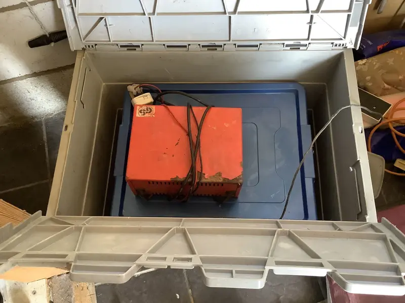

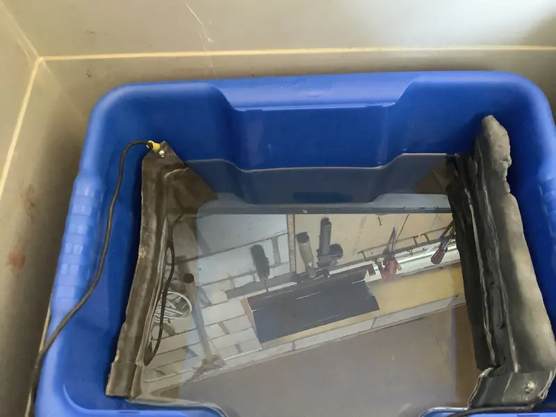

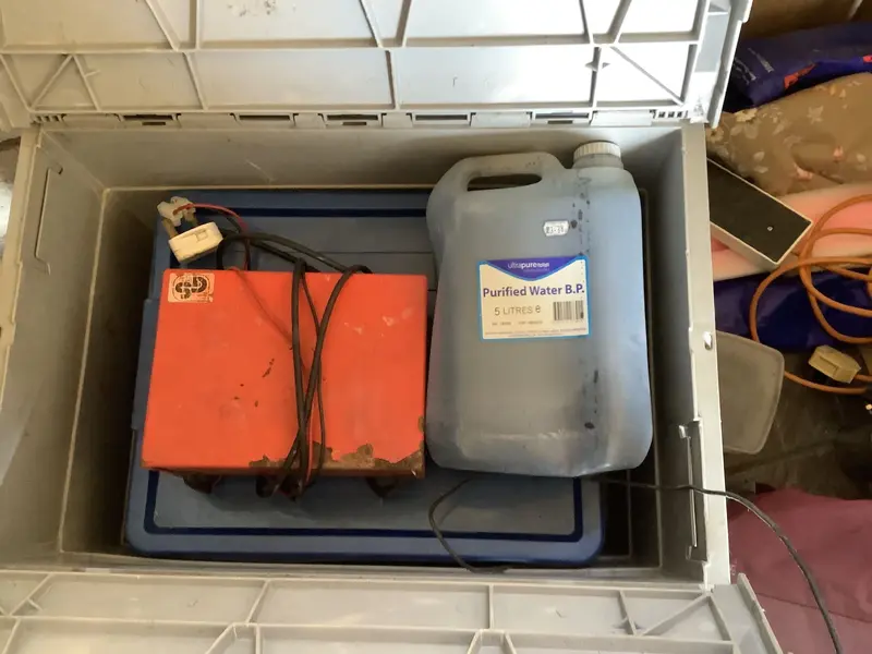

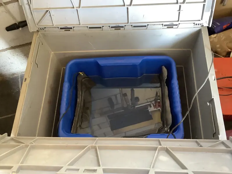

Please can you give a run-down on your anodising kit? I've always assumed that this was out of reach of the hobbyist so I'm intrigued. Can you do colour?
Maybe this subject needs its own thread?
http://www.uponone.com/howtos/1.pdf
Ok, see photos..and a link to Ron Newman re: Moo lite focusers...
In the pics you see the containers and in there is sulphuric acid aka..battery acid. Diluted to (can’t remember of hand) see link..
Also are the lead anodes..big is better, your piece being the cathode..
One old charger, not a smart one...no good for this...
The dye...order on line..
Purified water...de-ionised...lots of it...Tesco etc..
Cleanliness is paramount ..
Rubber gloves and eye protection..imperative!!
Hope that helps..please ask if more info needed
Ray
