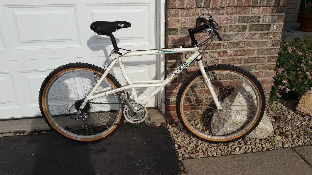

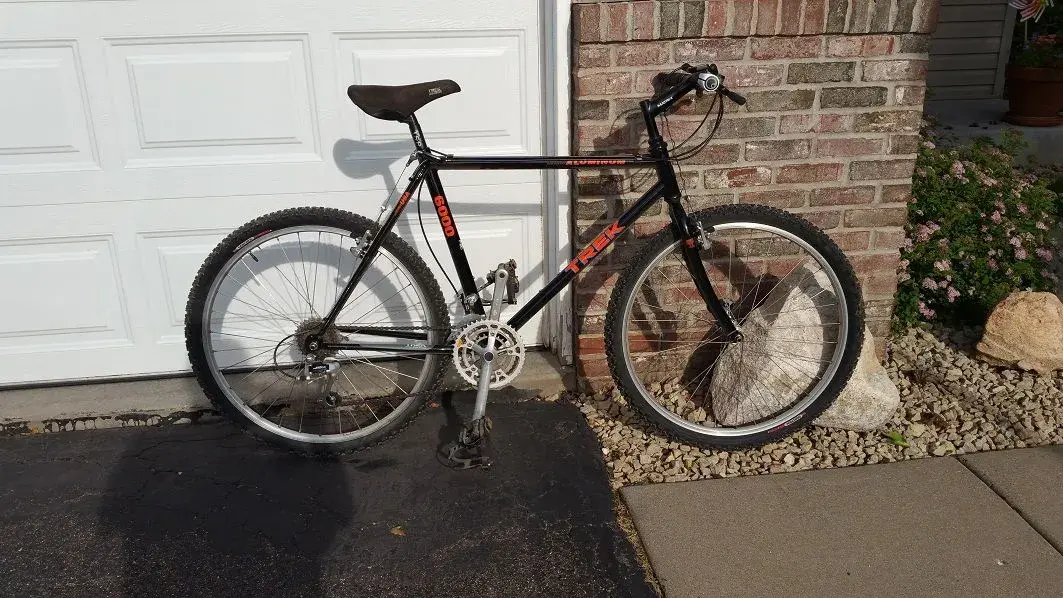

How do I attach pics? Do I use the upload attachment or...?
Trying pic attachments...

Great looking bikes.
Must have been a very dry garage. It's good that they were hung up rather than left standing on the floor as that would have certainly led to cracks in the tyres over the years.
