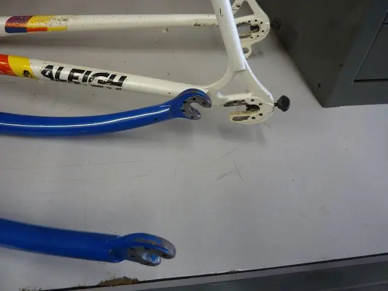

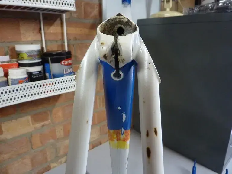

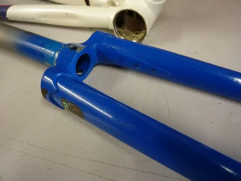

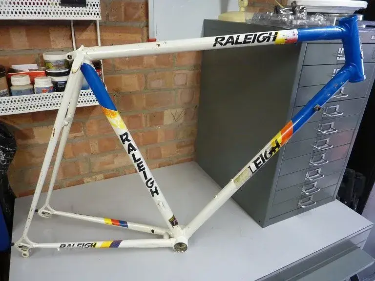

Well, it has landed, and was very well packed thankfully, there are no dents, all the threads are good, so just a bit of surface rust and rubs to show for it's age. Here's some pictures of the frameset for you MrW.
It's 56cm C-T seat tube and 55.5cm C-C top tube (which is almost my size :D ), frame weighs 1750g forks 670g.

I'm not very up on SBDU frames, but thought that the frame number indicated an early 70's bike, which would mean this has been painted at some point during it's life.
The much later purple 753 decal would also suggest this...
I'm not really sure yet :D .
It needs a respray, but I've not got the inclination or money to have it put back to the 70's team livery, so maybe a locally sourced single colour respray?.
I think you're right about the age, I've seen some framesets on here and on the net that are close number-wise, and they are attributed to the mid 70's, hopefully someone here will be able to enlighten me further?.

Given it's rarity, I would be inclined to go back to original, even if it means waiting until funds permit (if I had won it on eBay then that was my intention)
Even if you went back to TI Red, and got the decals from H Lloyd or similar, it probably wouldn't run into a great deal, and it would mean it had it's identity back.
It has clearly been painted at some point, and the head badge changed, as the one it has didn't appear until the 80's (if you carefully remove it you should find the original rivet holes for the older badge)

Above is a rough guestimate so 1977-78 which ties in with the drilled dropouts and the drilled fork tangs. Being an "H" personal order you could persuade SBDU to paint it whatever you liked. Gold, Silver, Blue, Green have all been spotted. There were some muddy brown SBDU frames on e-bay recently, not my personal choice LOL
