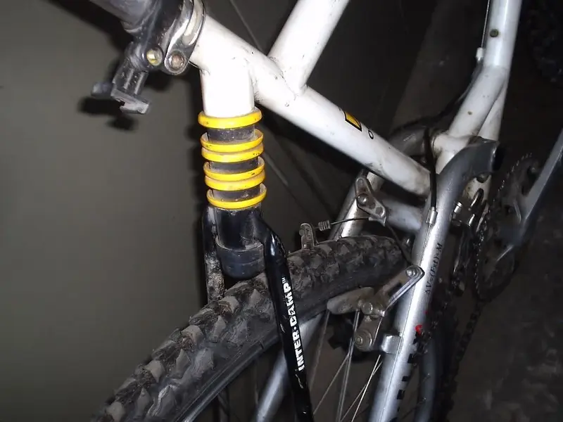

I wasn't looking for this bike (suspensions a fad, right?) but it found me anyway so the least I can do is get it rideable so I can see what I was missing before I sling it back.
Most parts will be OK, what bothers me are the rear elastomers, which are solid. I checked Elite 405 on Ebay, any other suggestions or substitute parts? I thought of a spring, but then where's the damping?
The swing arm pivots move with no play but I haven't dismantled them yet. Looks like a synthetic bush; what sort of lube should be used?
I guess 1991, anywhere close?
I know nothing of Pro-Flex so links to history or catalogue scans would be much appreciated.

1990 bike, and IIRC, there was an aftermarket elastomer thang for them with a single big elastomer for more travel than the stack- elastomers are basically self damping springs, actually a good enough idea for suspension- lightweight, zero maintainance, but limited travel and prone to UV deterioration- the new units from Rapid Descent or that SLIM here has gotten in the past are UV resistant.

Thanks for the info. looks like rapid descent should be able to help, I'm off to do some measuring.

I bought mine from Ultasport, they where my clients at the time, still have the bike, all in work8ng order , but need new suspension elastomers. Any idea ? , tried making my own out of polymer , not very succcesful.

Skateboard truck rubbers can be used as elastomers if you want a cheaper alternative. There's info on here.

Counterintuitive though it was, the rear suspension only worked when the bolt was fully tightened. I thought I'd been sold a pup at first. No movement at all, so I investigated an discovered that the bolt was very loose. Soon sorted.
