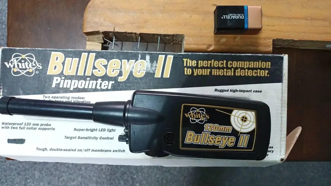

a pinpointer is as good of a method as any and you can by stupid expensive one's just for wood workers with fancy names printed on them. I've never bothered but know a few people who have and they all get mixed results.

I usually drill out the nails holes with a cheap jobber bit. That cleans out most of the metal. The pin pointer will hopefully help. The obvious answer is to get a spiral cutter made of something hard. That would cost more than the planer thicknesser.

Thanks everyone. The gizmo duly arrived and I have just done a quick test. It found these pieces of metal that were stuck in the old nail holes:
My son took it as a personal challenge to get these out. In future I’ll drill out the holes that light up with the cheap jobber drill bit. It certainly does the job and I’ll feel a lot happier sticking the planks through the planer/thicknesser.
