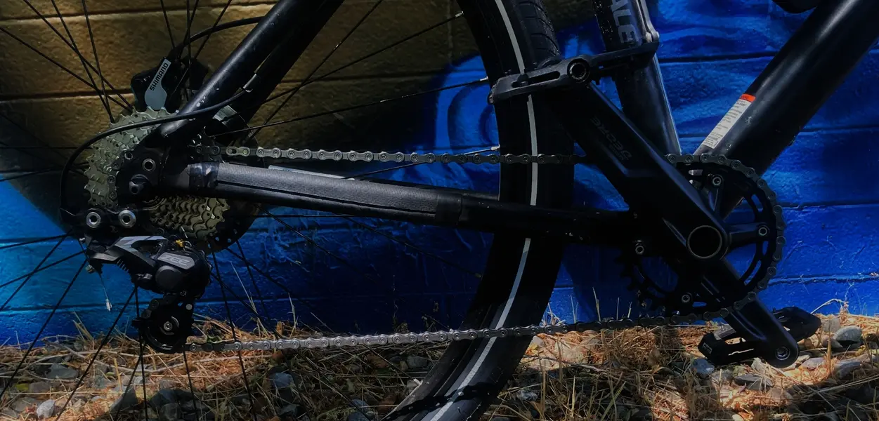

The pics are of an octalink and ht2 cranks, and the final one with cranks mounted is an ht2.

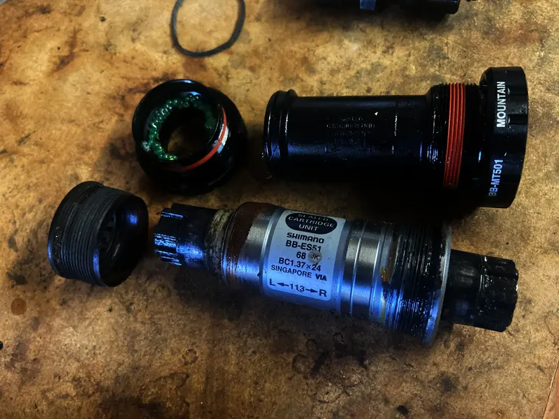

Don't be. Every day is a school day. I've learned Cannondale pioneered the bb30 and research suggests that the f29 was a bb30 frame at some point in its past (2015 on a review I read).
So, is yours a bb30 with an adapter in the BB to allow standard threaded bbs? I'm curious.
Mine is a 2008 with a threaded BB shell, no adapter.
The lower BB in this photo was the one I just replaced. The black one is the one I just installed.
