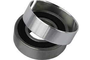

Something like this perhaps?
If you want to try that approach, I guess you have to find a decent shim supplier, then sit down with the hub measurements, and dimensions of common bearing sizes, and see what might work.

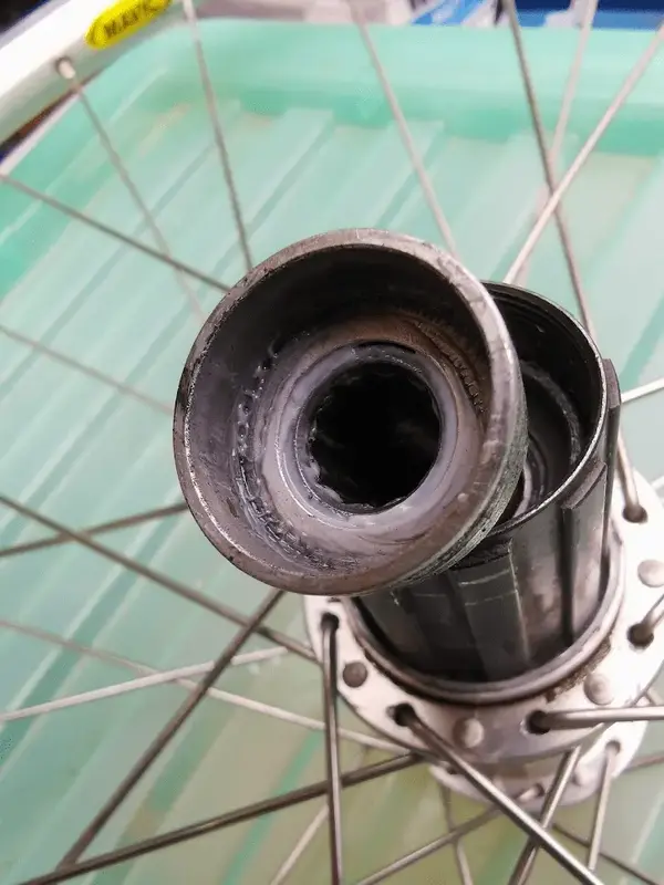

So thought I'd take the freehub off, except I found out there is a custom bearing holder that is held in place by the freehub bolt, that sits on the M737 freehub bearing race behind it.
Faff and a half bodge job these hubs. Are they really made like this.

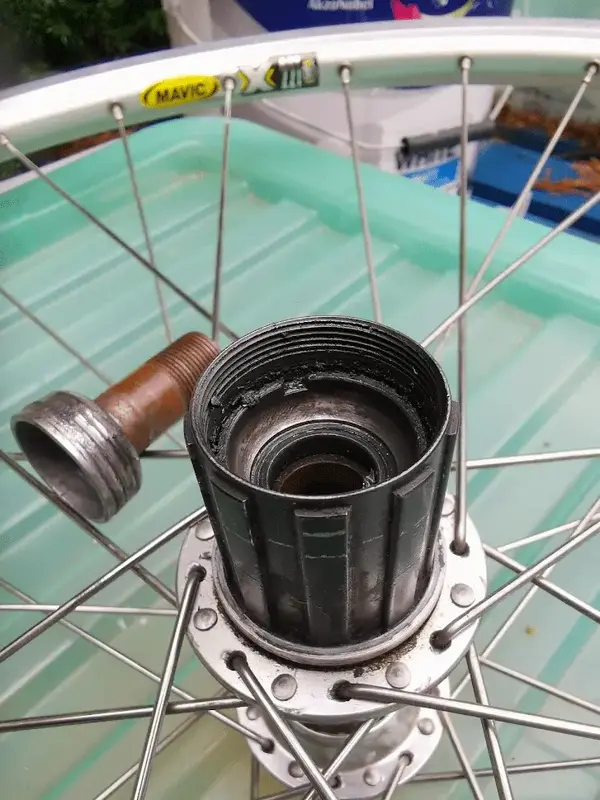

So photo time @kingoffootball
Bearings are 3/8" ID, 7/8" OD and 9/32" width
The bearing holder is about 22.5mm possibly a bit more (7/8" of the bearing OD is 22.2mm)
Approx. layout as is
Yes, they really are made like that unless you have a later one with the proprietary freehub, they bodged a Shimano freehub I think.
So the bearing holder is a bit too large for the bearings and they need shimming, but that isn't wat's causing the binding, right?
