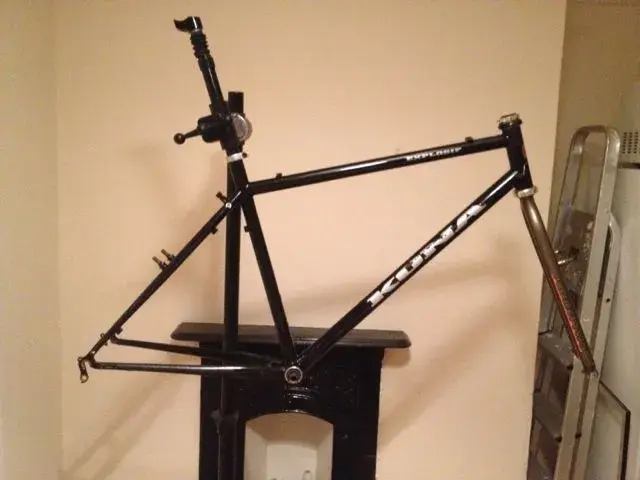

Now then. Finally got this one home, examined it properly and took a few pictures.

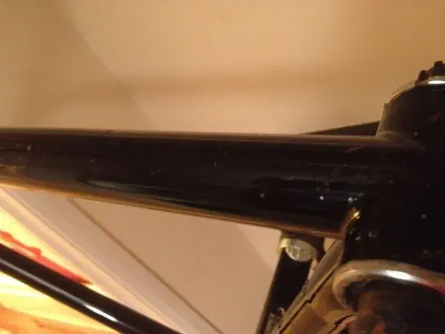

The paintwork is in surprisingly good nick - a few scratches here and there as you would expect from a frame of this age but not bad at all, virtually no chainsuck marks, and the original owner clearly took care of it judging by the incredibly neat black tape that has been strategically placed to protect the frame from cable rub. A few rusts spots in the scratches that can be sorted out easily enough. Dent and crack free.

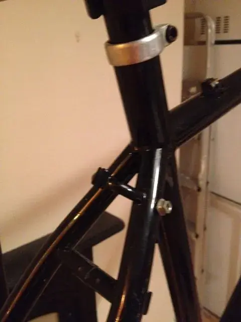

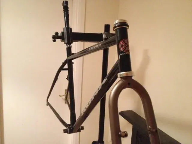

The frame number is indeed F311372 if I've read it right. Paintwork is (I think) very very dark blue - but in some light it appears black. The canti hanger is very tidy and is 'looped' rather than the straight hanger stays on my 97 Hahanna singlespeed. There are indeed three cable stops on the top tube, slight offset to the right (some cable ends still in there I will need to tap out), and the cable stop on the seat tube is nicely angled to avoid kinking the cable. The down tube does seem to be fluted - hopefully this comes out in the pics - and the seat tube morphs into a smoothed box section by the bottom bracket. There doesn't seem to be any ovalising of the top tube.
Hopefully you will find the pics useful - not great light in my kitchen and only on an iphone, but better than before I hope. Had to reduce size to upload them, so apologies if they've come out too small (still working this out)!

Fluted down tube says '93 doesnt it?

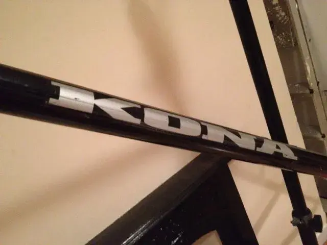

Decals are 94, the correct decals for the fluted down tube have lines through them so they sit correctly on the fluting.
Id say its been repainted in its life as it should be grey front fade to bluey-black at the rear iirc!

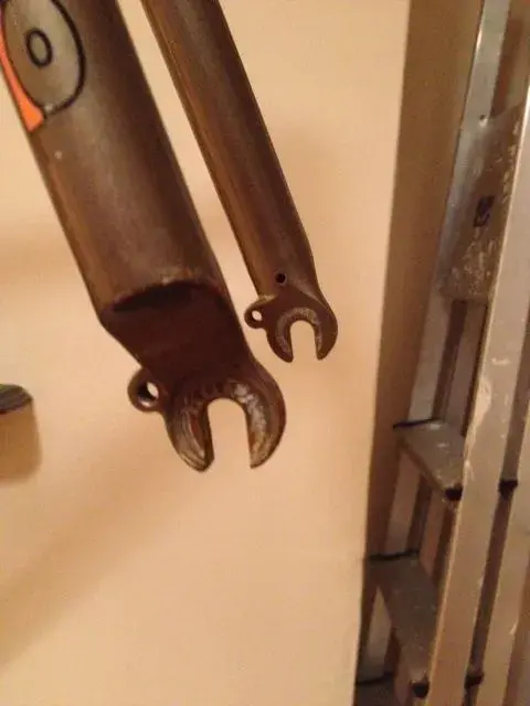

Rear dropouts are the wrong type for a '93 Explosif.
My guess is that's it's a '94 frame that has had the rear cable brake stops brazed on as an alternative to the dog collar, then resprayed…Either way, very cool frame! Get it built, these ride very nicely :)
Thanks all for your help identifying this one. I think you're probably right that this is a 1994 model with some aftermarket changes to the cable guides. I have to say the frame work is top notch and has been done extremely well. Rather pleased as it means it is unique yet I don't have to worry too much about protecting the original paint job. Plus if I'm honest it corrects the two design flaws with frames of this era - downtube cabling where they were exposed to mud from front wheel, and the use of the dog collar which was always a bit of a bodge IMHO [runs and hides].
