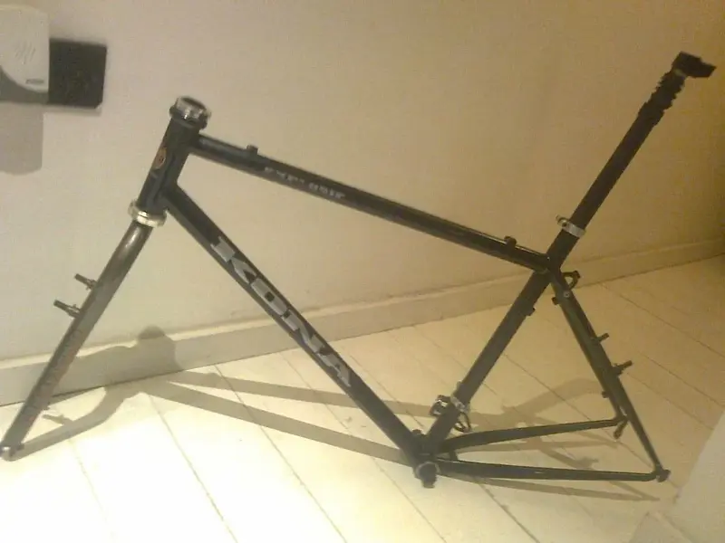

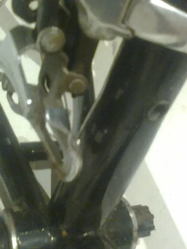

So I saw what appeared to be a 19 inch Explosif frame (with P2s) gathering dust hanging half hidden in the corner of a second hand bike shop. No dents or cracks, surprisingly limited scratching, seatpost moved, BB looked newer than the frame (splined) so hopefully should be ok. It was so cheap I couldn't not take it home. But it perplexes me a bit...
It's midnight blue (very very dark - almost black), has silver threaded P2 forks, has a 'splined' effect on the down tube if you look closely (or feel it), and a rather well crafted 'bulge' toward the bottom of the seat tube below the front mech clamp. The decals seem original and from the 94-95 era (as does the seat clamp), but looking at the catalogues on here I can't place it. Now for the bit that really confuses me - it also has a canti hanger on the seat stays, which only seemed to be present on lower end models in the 97 era I think...

OK - not quite sure how accurate this is - a few paint chips and slight paint bubbling was making it hard for her to read the numbers:
Text parallel with the direction of the BB shell next to chainstays = 4T05
Text perpendicular to BB tube by LH pedal = F3113722 [but she wasn't sure whether the first 1 was a scratch or a 1...]
Text perpendicular to BB tube by RH pedal = BT
And she even managed to take a couple of pictures with her ancient nokia - which should appear below if I have worked out how to upload pictures:

The frame number beginning with F is the one you want. It would suggest the frame was made at the Fairly Factory in November of '93. This would make it a '94 frame.
The pic's are less revealing :? Not only is the rear canti hanger an oddity but the gear cables running along the top tube is strange as well. Is there three sets of cable stops along the top tube?(2 gear, 1 brake) Kona's of this period ran the gear cables along the downtube requiring a bottom pull front mech, this one clearly takes a top pull.
Very strange...

Yes - three cable stops along the top tube (forgot that in original description - I too thought that was odd). They're slightly offset to the right I seem to remember.

Hmm, curious. Let's see some shots of the drop out's and more close up's of the canti bridge. The splines definitely indicate a 93 - does the tubing ovalise at all on the top tube?

If it's got the fluted down tube then there's nothing dud about it regardless of anything else :D
