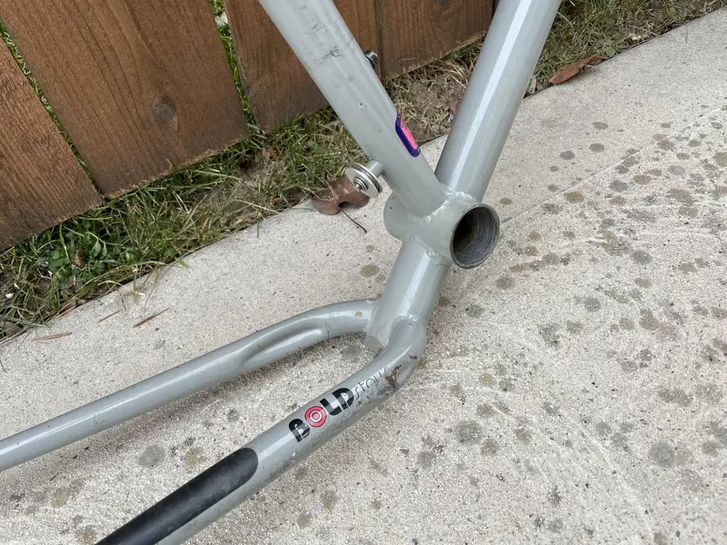

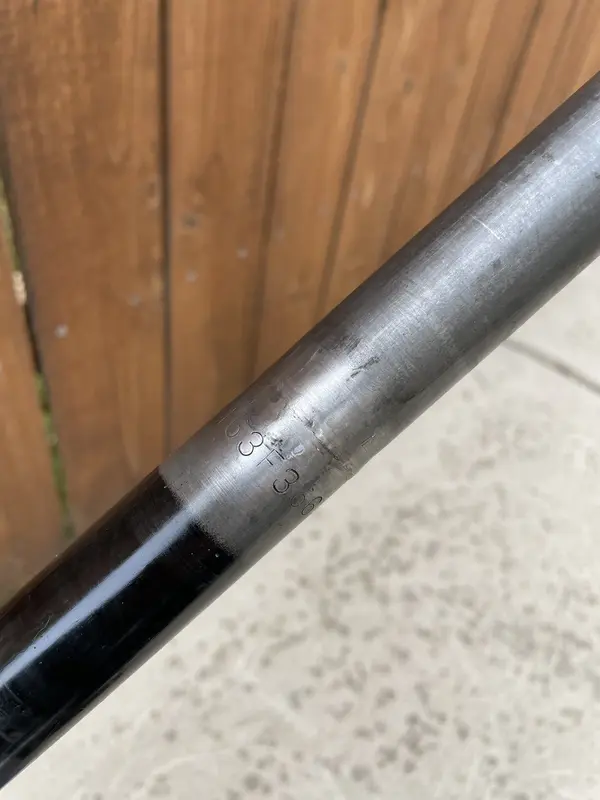

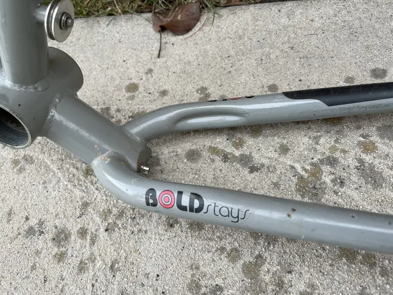

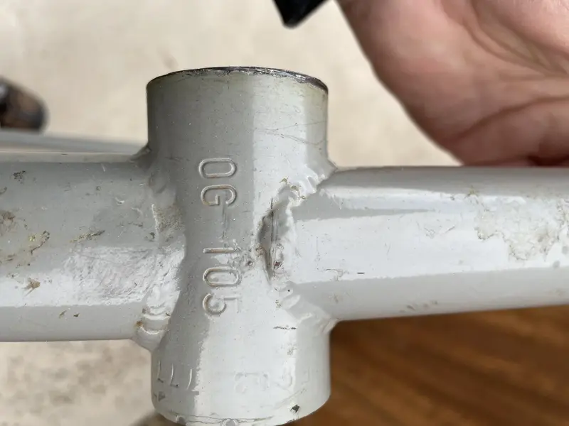

I picked this frame up about 15 years ago for all of $20 and still haven’t gotten my money’s worth out of it. It’s spent most of that time hanging in obscurity in my garage. For a short while it was a fully built, functioning bicycle with some Accu-Trax forks and GT branded Hadley- hubbed wheels, but over time those parts were harvested for other projects. Later, I sold the forks and put the wheels on my 91 Wicked Fat Chance (another project).
Anyway, I’ve accumulated enough parts to Frankenstein this one back together but damned if I haven’t been able to learn anything about it in all those years. Maybe you all can offer some insight? Here’s the solid facts I know:
1-1/8” head tube
Sloping top tube
135 spacing in the rear
26.4 seatpost
U-brake / rollercam rear
28.6 front derailleur clamp diameter
16-3/8” chainstay
18-1/2” CTT seat tube
22-3/4” effective top tube
Seat tube ovalized at the BB
Montagna on the down tube
Sommita on the seat tube
Boldstays on the chainstays
Montagna Innovation head badge
Any help you can give is greatly appreciated!

Thanks for your input Ted. I don’t think it’s a great frame (maybe it is) but it’s certainly not terrible. It’s definitely interesting with that strange BB/downtube junction. I’m thinking I may hang some of my funky parts on it just for fun. Wish it had cantilever mounts instead of U-brake…
