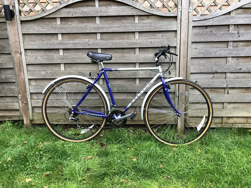

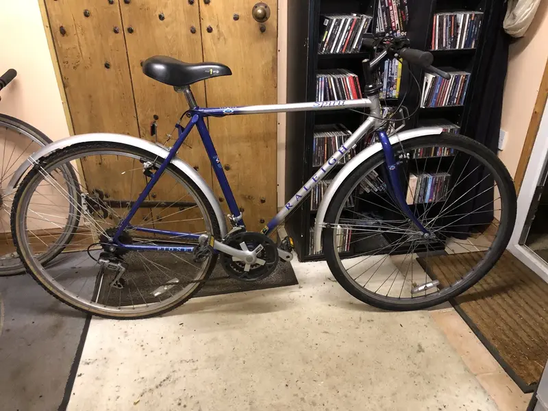

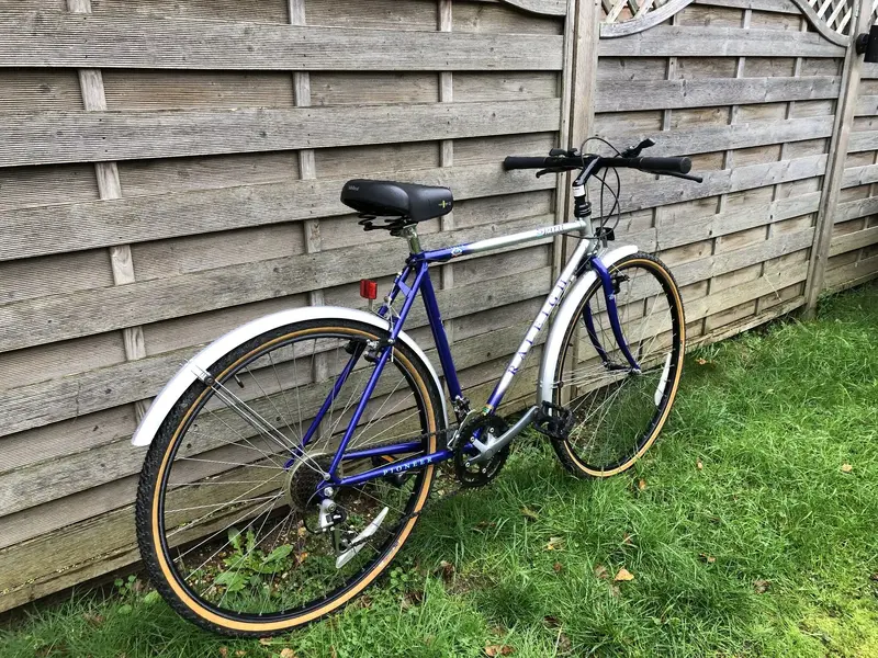

Me: Nah, I’m not going to bother with 700c bikes any more..
Also me:
DE764441-F72C-4868-AF6F-DE565FE9E543.webp 095BA011-EDCF-49E1-B334-B65EEDAEC471.webp

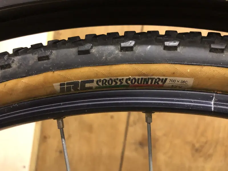

They’re both pretty mint, but check out the IRC tyres on the top one:
Plan is to make one really nice one out of the two with a few retro mtb parts thrown into the mix for gravelly winter mudguard type adventures..
I’ll use the bottom ones frame (20.5”) as the top one is a mahoosive 23” c/c. I know they’re not strictly mtb’s but they’re not really road bikes either. I post a pic once I’ve finished, should be fun. :)

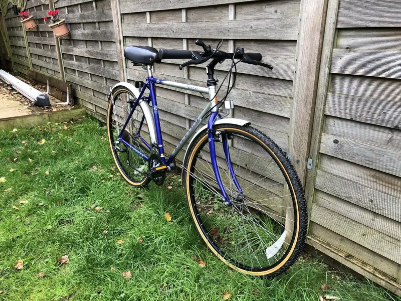

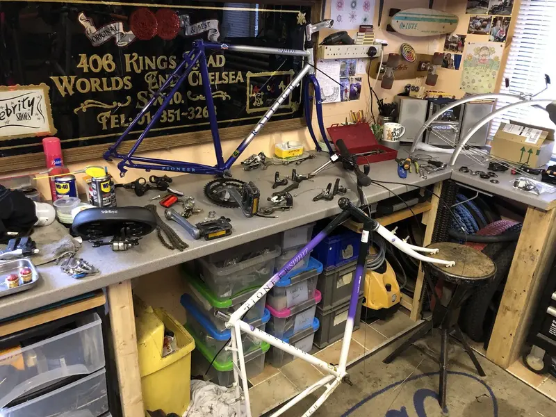

Build day today.
Got the XL frame stripped down easily and spread the components out, I’d previously taken the smaller frame apart and given it a quick clean up.
Went together really well, only sticking point was the bb spindle was a shade too narrow for the new crankset, I’d already stripped and serviced it so…
691214C3-ED81-4ECE-B720-DB2DC99A857A.jpeg B4AD1EAE-6C00-4CEB-9D24-347D4A0F6D2D.jpeg

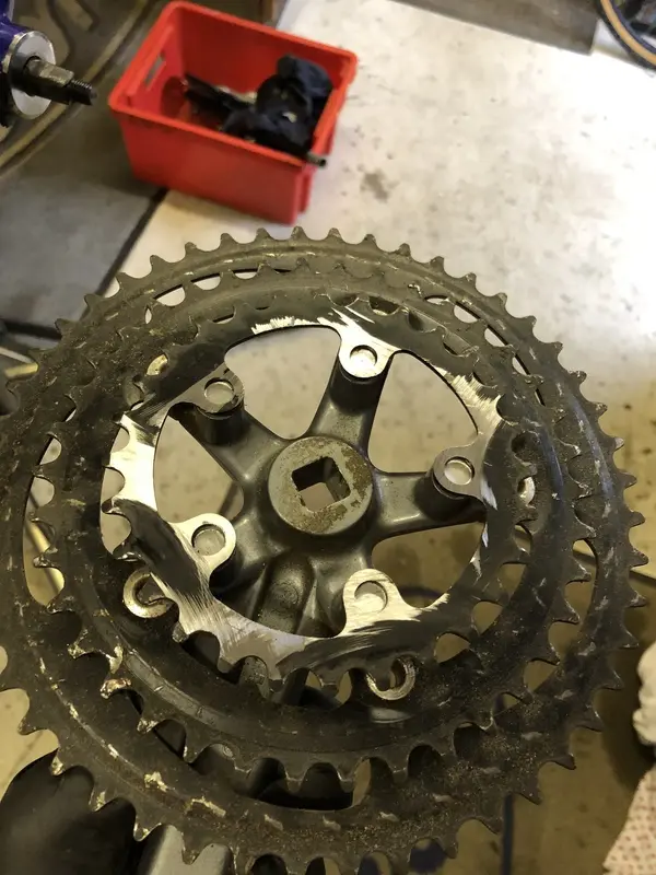

18 speed to 12 speed conversion courtesy of my angle grinder.. I honestly don’t think the granny ring is necessary on a bike such as this, and it cleans up the look of it imho:
C61E63CD-A0DD-40C9-B58F-A26CF54C79AF.jpeg 00587964-CCE1-4C3B-B388-66FE30354427.jpeg C15CAC31-858F-49F0-B361-06B35105019D.jpeg
Lovely. 200GS group with the (much underrated) thumbie shifters should be spot on for winter adventures.
All in cost was £65 for the two bikes and I’ve not used anything from my spares box at all. What do you all reckon??
