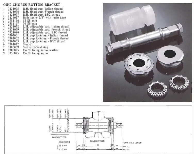

I went to fit these Nuovo Record cranks on to what I assumed was the matching bb - not so, as you can see from the photos! On closer inspection, the axle is marked "68 SS B" which I've never heard of. The matching axle should be a 112mm "68 SS" for my British threaded frame.
The cups aren't rifled so I can rule out that at least the cups aren't Nuovo Record. The axle measures approx 110mm and the right crank butts right up against the chainstay and isn't even sitting on the axle firmly at that. Is this an Athena etc?
I'm entirely doubtful whether the matching 112mm 68 SS BB set would be long enough, but in theory it should be spot on for the Nuovo Record cranks. Given that this is a winter bike, I could probably do with a cheap sealed BB unit. Could you recommend a unit that would match the cranks, please? Ebay links would be most appreciated.

Tifosi might have something to fit,? Campag did some combined road / track bottom brackets but have an idea they were stamped CP or something. I wonder if it's a symmetrical Chorus RS?
I think that BB might be Chorus - that had a 68-SS B marking according to the dealer manual. 1/4 balls 111mm axle and non-rifled cups. RECORD had the same axle marking but had 7/32 bearings and rifled cups

Ah, might be chorus then :)
