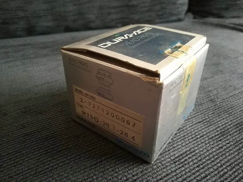

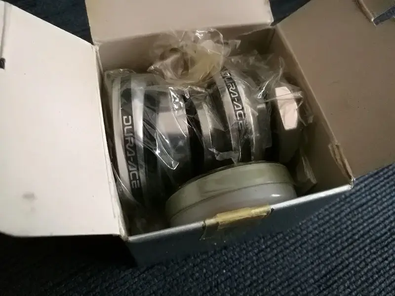

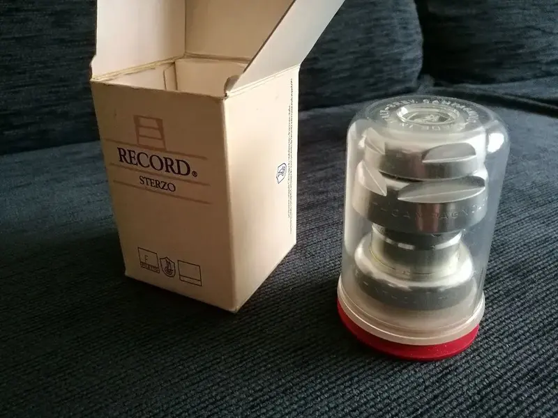

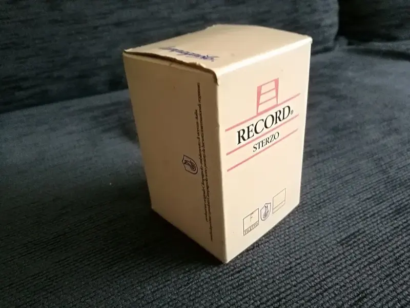

Up for sale are these three headsets, NOS-NIB conditions. Prices DO INCLUDE shipment to UK/EU. PayPal as friends/gift, covering fees by buyer.
- Campagnolo Record Sterzo . 60€
- Shimano Dura Ace HP-7400. 60€
- Shimano 600-Ultegra HP-6400. 45€

What threading are they? The Dura ace is french threaded, going by the sticker on the box, but what about the other two? thanks
one-eyed_jim":3d7grfjq said:
The Record is French also: "Filetto - F".
That´s it, thanks mate.

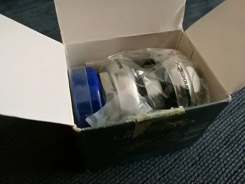

The 600-Ultegra headset has this specifications:

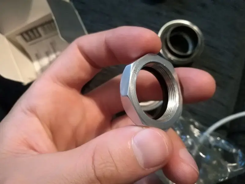

Sorry, I read it wrong... the specs are for both types, we need to know which type this one is. If it's not on the box, it will almost certainly be stamped on the lock ring
Took the headset out from its plastic bag, and didn´t found any inscription... :shock: Nor in the locking nut, nor in any other part.
French headsets normally have a washer with one flat edge that corresponds to a flat side on the steerer:
https://i.ebayimg.com/images/g/Qz0AAOSw ... -l1600.jpg
Other headsets usually used a tabbed washer that fits into a groove in the steerer.
Here's a French Shimano headset with a flat-edged washer:
https://www.ebay.co.uk/itm/Shimano-Exag ... 2927339710
https://i.ebayimg.com/images/g/rmAAAOSw ... -l1600.jpg
Here's a BSC headset with a tabbed washer:
https://i.pinimg.com/originals/74/c1/4c ... 81b195.jpg
