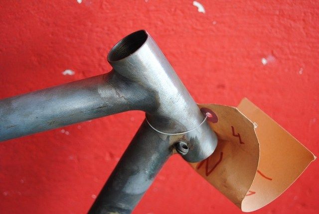

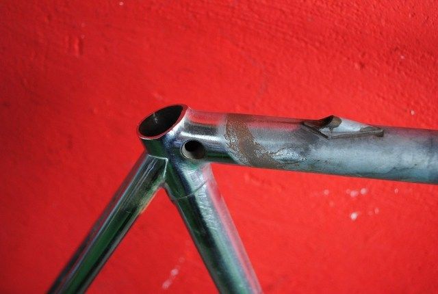

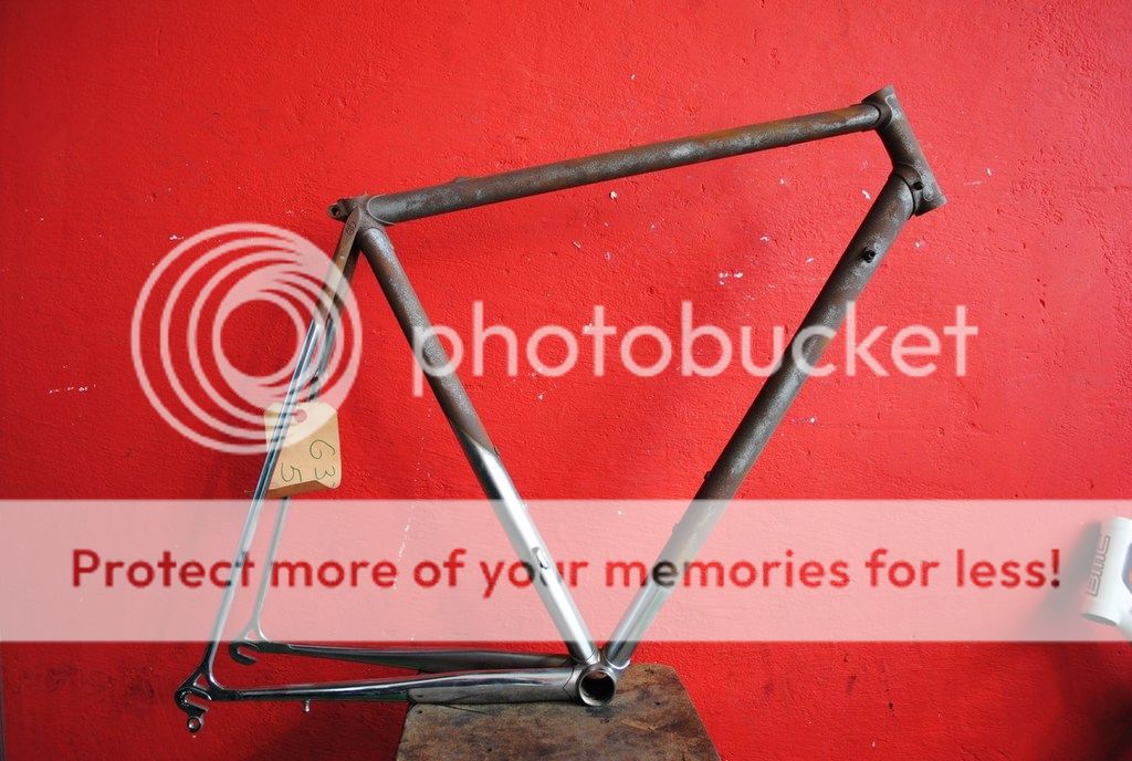

There is no way that one I linked to above is a 'pukka' corsa extra and the fact it looks like no Merckx I have ever seen. A Corsa Extra is a specific model with specific features of which that one linked has none, its not even a lugged frame. It may be the odd one out or a mistake made in translation or something but its more than enough to arouse suspicion. There is also another corsa listed that has what look to be Max tubing tapering into the bottom bracket, definately not a corsa. May be another model but whatever it is it isn't a corsa. I'm trying to be open to being wrong or misunderstanding the guy but to be honest what he is advertising some of these frames as is wrong, whether its just the model or if its the manufacturer is open to debate.

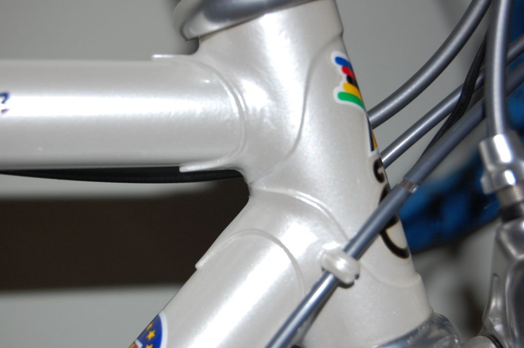

Just to for comparison here is the one listed above against the details of my own Corsa Extra purchased through the factory in Meisse.
No lugs?
Lugs
Seat stay top caps and seat stay binder?
Bottom bracket doesn't look right either.

I hear what your saying Donny Dee but I am positive that the one I put the pictures up of is no Corsa Extra. It has features that have not been seen on other Merckxs, let alone a Corsa Extra.
