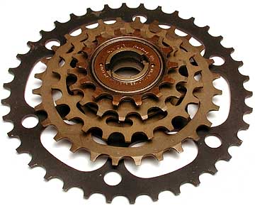

I'm pretty sure I'll have a freewheel then, do I not need any special tools then to change it out for a modern one? Looks like a chain whip will probably do it?!
A chain whip will only rotate it backwards and click the freewheel. :wink:
You need a tool that fits the (stationary) inside part. There are an enormous number of different tools (two or four pin) and other freaky arrangements. If you are lucky enough to have a Shimano freewheel, then a stock Shimano cassette lockring tool will fit. It's simplest to go to a decent local bike shop with a packet of biscuits at a quiet time... 8)
See here, the tool fits on those two slots in the middle. As the pedalling forces tighten the freewheel, it can be on VERY tight. Fitting the tool into a vice and using the entire wheel to undo it is easiest. If you have a loose hub then you are already in trouble.
