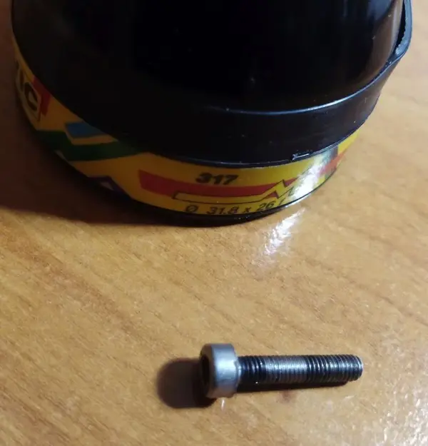

You'll be needing an M3x0.5 thread 18mm long stainless steel caphead screw like this:
