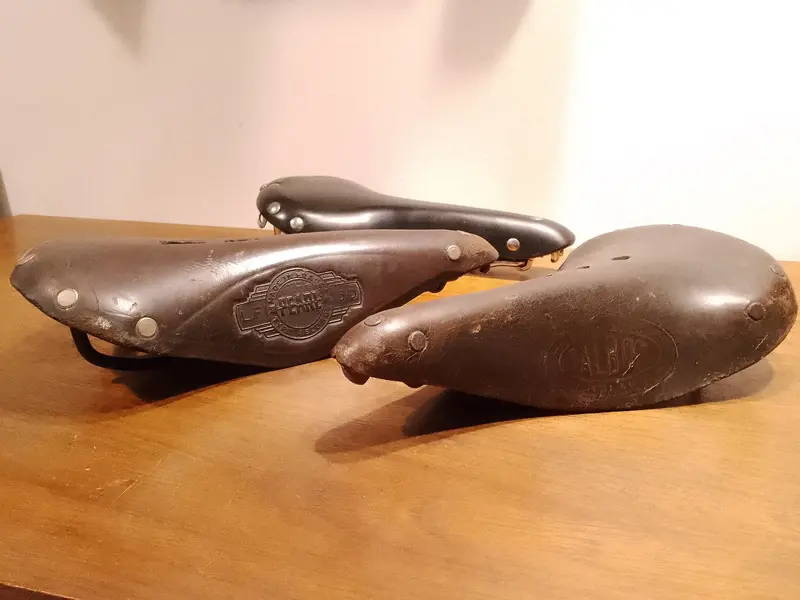

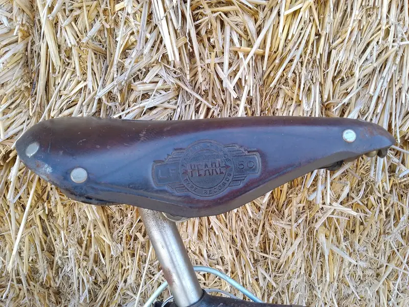

And tonight we have a saucy three way saddle swap!
Nearly eighty years separate these three saddles...
The Talbot is the original saddle from my French "Pepe's" 40's France sport with simplex tour de France 4 speed derailleur. ...an amazing groupset with awesome shifting for its time quick and precise.
I've been slowly breathing life into the Talbot and pearl which I think is late 60's ready for this swap around....
The black saddle is only a 5 year old...damn good saddle tho....brooks take note!
So the pearl is for the Nocim...
Talbot goes back to where it should be..
Black one...dunno!
So which saddle do you reckon is the lightest at sub 500g?

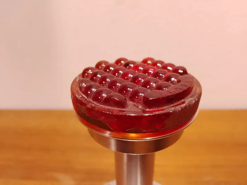

A little turning down of the flange and some internal polishing plus a gorgeous glass lense and we have something rather cute....
Dump a few watts of LEDs through the polished guts of the hub and voila...c'est magnifique n'est ce pas?

(...)So which saddle do you reckon is the lightest at sub 500g?
Is the oldest saddle also the lightest in this fine ensemble?
Some of my all time favourite components i.e. Cyclotouriste cranks and Cyclone GT derailleur etc. are lighter than most modern equivalents I’ve encountered.
Mickeyspinn
rBotM Winner
Top marks 👍

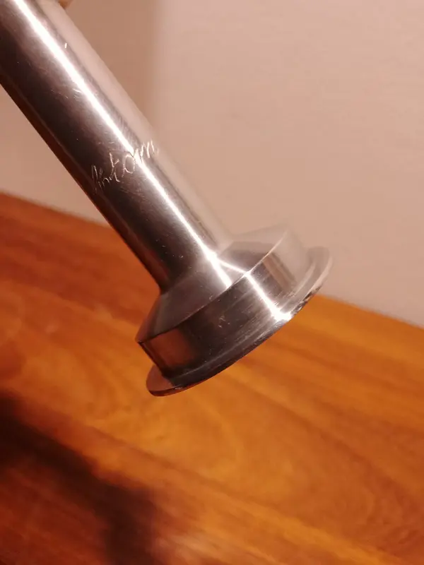

It's around 150g lighter it'll be fitted onto a domed top steel seatpost that weighs under 100g with an alloy clamp that doesn't really weigh much either! However the saddle is too precious to be ridden often so the pearl will be fitted to the Nocim.

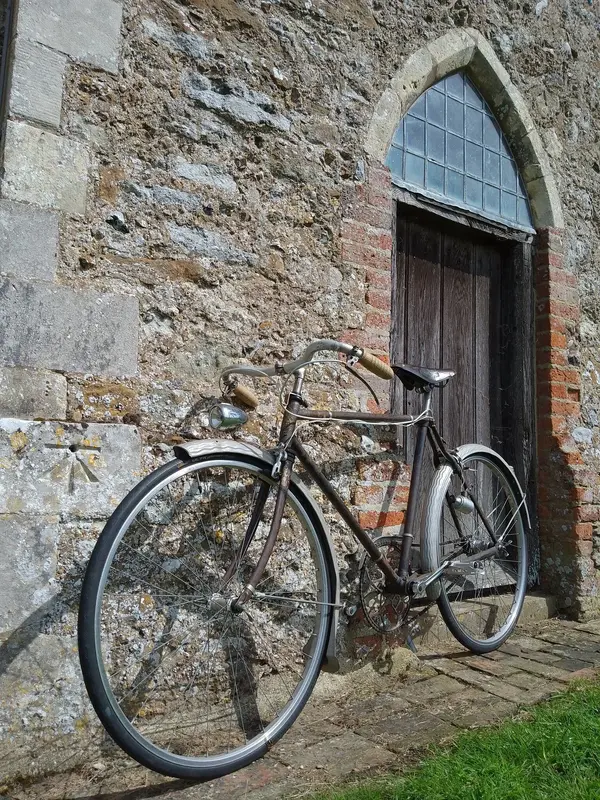

Had a lovely peddle about today the old boy didn't miss a beat or a trick. Roasted an ebiker too...✌️ hah .
Okey dokey spokey it's chocks away time chaps...

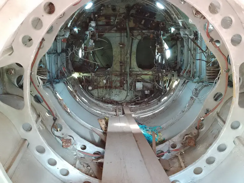

This is the noisy end of a de havalland vampire
And this is the other end

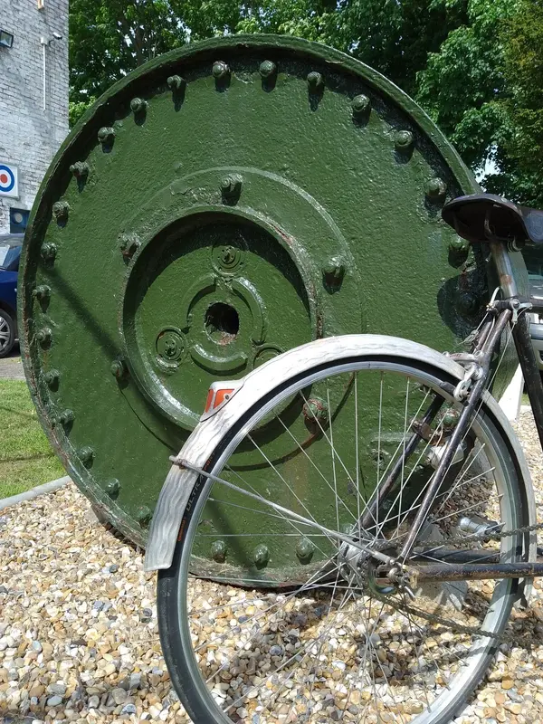

That's a bouncing bomb dam buster stylee 🤨

What is it about bridges? Always have to stop on a bridge!
That's what the marsh looks like...it's flat ..fields and ditches and dykes everywhere! About 80 square miles of roads that lead to..bridges,fields ditches and dykes and other roads that lead to....yeah you got it.......oh and churches of the middle ages! Loads of em!
Oh look a church...bit of it is about 1200 years old
So a bit older than my bike!

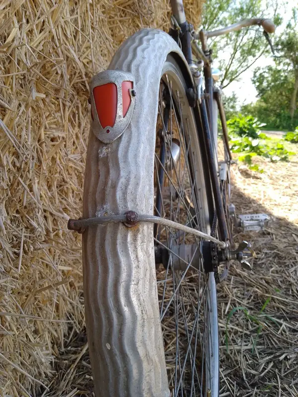

Say hello to Sid and Nancy..
Built tough.... train chicken and i win!
Lovely fenders!

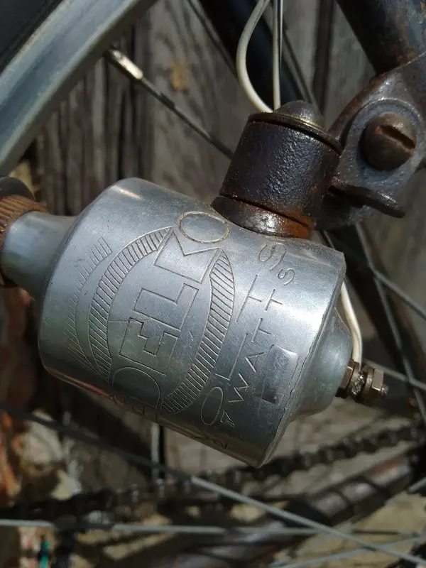

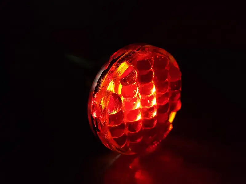

Rear light works👍 but not at the same time as front...dynamo chucks out a belting 2.7w so not quite enough to go around!
I think this saddle is going to settle in nicely..very comfy a bit more slender than a b17 champion standard. Think I'm going to like it 🤩

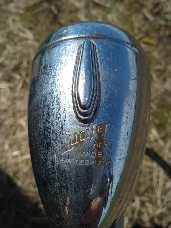

Danger danger high voltage ⚡ took hours fiddling that apart to get it going stunning bearings in it....late 30's quality 👍
However I think if I lit a fart I'd probably see further 😊
Doesn't keep time but it does shine 👍
Ooh me pearl ❤️

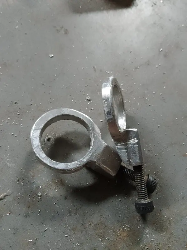

Well it's happening frequently now ...once about month or so ago twice yesterday and once today!
Officially a problem...... actually a nice problem !

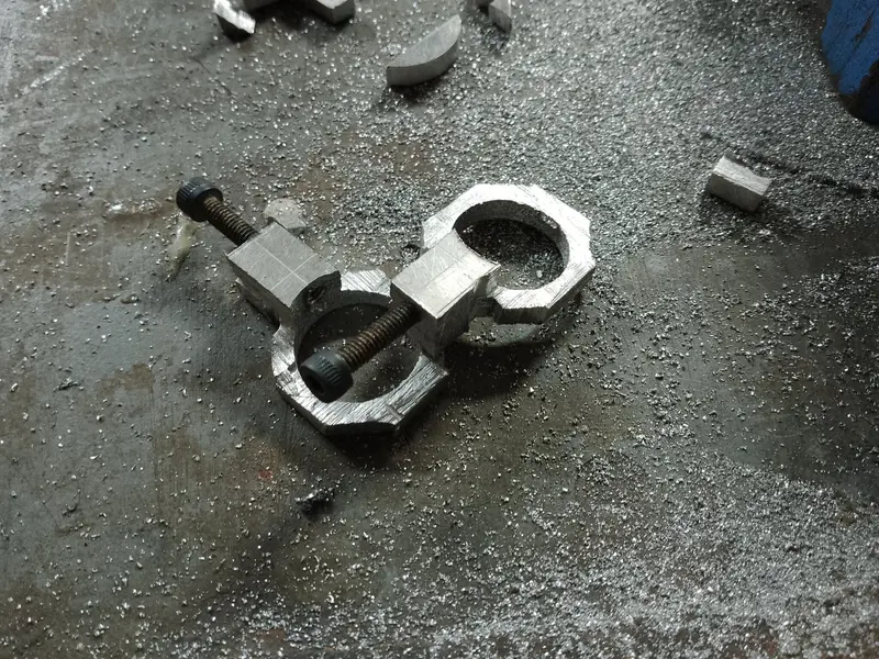

I must be getting stronger ... Really didn't think I'd produce enough torque through a 64 tooth chainring .....I keep budging the rear axle!! 😁
So it's ditch the wing nuts and fit some axle nuts....nope...I like my wing nuts I found them on an old Peugeot randonneur bike in a ditch in france as well as the chain guard,front axle and other various bits !
So I need some anti budgie axle bits!
Best get making some.
Brass or aluminium?
Well the new saddles no lightweight so it'll be aluminium 👍

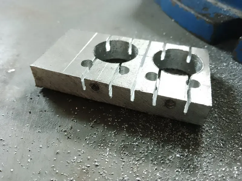

A little bit of drilling a bit of tapping and a bit of hacking....
Roughed out ready for some more filing!
That's about it for the "tugging the axle" bits ....tomorrow I'll make the "keep hold of the dropout" bits..
Yep a little rough....just the look I'm after... handmade....the mother of necessity look!
I'll probably give these a tumble in a big ol'bucket of rusty nuts and bolts to help the patina bloom 😄

So as I was having my dins last night I realised the next bits "the keep hold of the dropout bits" were going to be a bit of fiddle to make....
Hmmm 🤔
Oh lord won't you buy me a milling machine
My friends all drive Porsches I must make amends...
I've worked hard all my lifetime no help from my friends

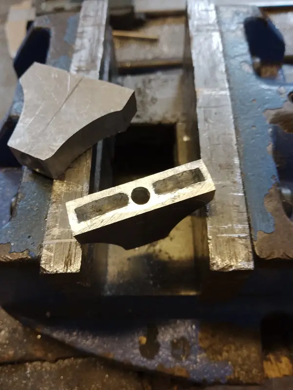

So with Janis in my head and before the sparrow farted I cracked on...hacksaw,files, scrapers, punches ,chisels and whatever else came to hand at the ready....got to make some square edged holes in aluminium 🤨
Righto of we go...
Roughed out of plate...
A 3 mm slot....stepped at the bottom too just for extra faff ..... a bit more tweaking to do then do it all over again on the other one....🙄
Felt they needed a little detail....they're lovely sliding dropouts on the frame and I didn't really want to cover the ends but well it needs these so I figured best add a little aesthetic something 😀
Nest stage finalise how much bolt/thread length is required make whatever adjustments needed and then fit! Reckon they'll fit first time? 😂

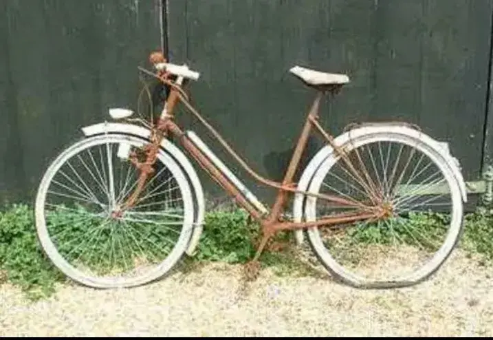

Just found this picture!!
This was on eBay for months and months buy it now £15.... I forgot all about until I was working on a job about 5 minutes away from where it was decomposing. Dropped a message heard back in 5 round there in 10! So glad I did....those are the mudguards,bars and dynamo on Nocim! Seller said it was a 60's bike.....moment I got next to it I knew it wasn't 😁
Lovely couple that were selling this had an absolute cracking story of how they become the "owners" of this bike 😂
They were newlyweds on honeymoon in the South of France...in the late 70's... obviously enjoying themselves. They'd been out all day visiting vineyards and I presume properly getting on it....the vino that is... and basically lost their car.....we've all done it haven't we?
They can't recall exactly how it came into their possession but the bike was in their hotel room in the morning ! So they brought it home to blighty...and lent it against the woodpile under a lean too where it stayed without moving till I bought it!
Looks rough doesn't it!
It's not actually as rough as you think.
It has charm it has patina....it has potential to be Nocim's naughty little twisted sister 😁
So it's a la Fileuese mixte of mid to late 30's quite a fancy bike for its time!
