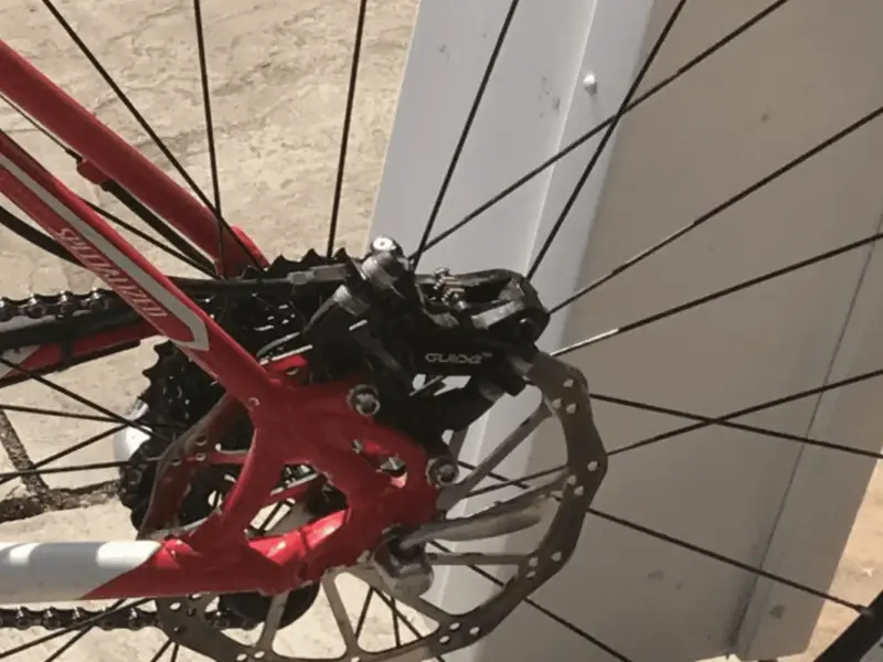

I have a pair of sram guide re brakes,they are 4 piston calipers,they are in excellent cosmetic condition though one needs bleeding.I took them off my wifes Specialized turbo levo sl when I fitted a set of hopeV4s for her she only has tiny hands and the hopes have much better reach adjustment.
£100 for front,rear and rotors.( plus one olive and threaded hose barb) In the images they are on my M5 which has now been sold frame only,leaving the brakes unused.
