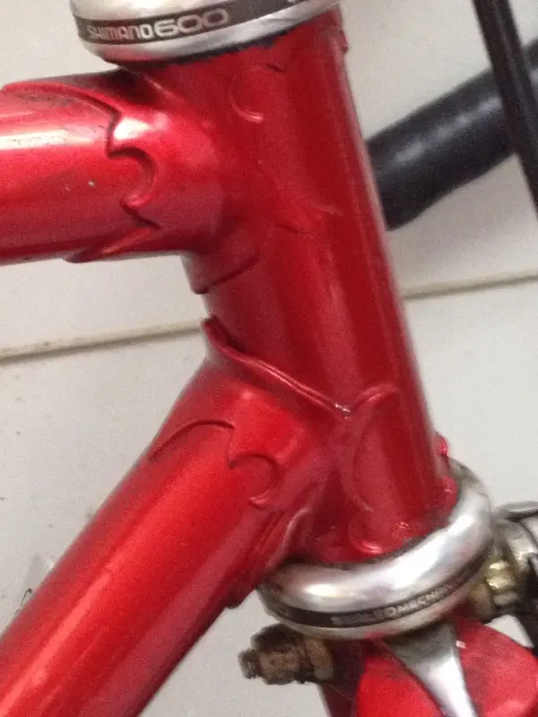

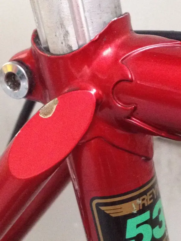

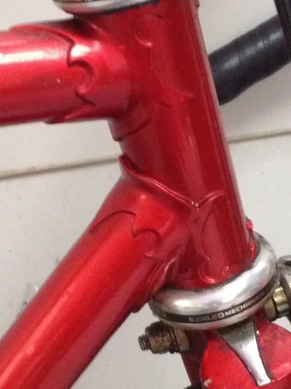

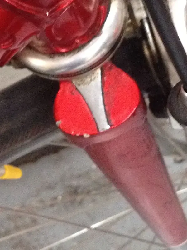

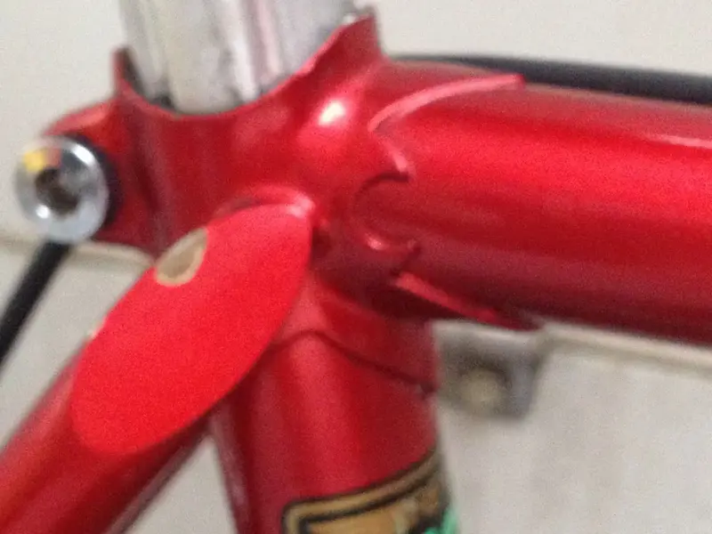

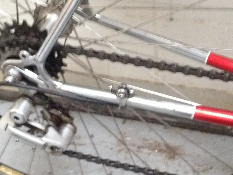

I bought this off ebay, not knowing what it was. But the lugs looked nice and it had some nice bits on it. I can't find any serial numbers, but suspect it might be a peugeot thats lost its plate. Its been completely resprayed. Any suggestions as to what it might be??

Simplex dropouts, Nervex Lugs I think??, some evidence of hand filing on lugs, only add on brazinngs are for rear derailleur.
Sorry for the terrible pictures. And I completely failed to realise that I had used the PX10 word. Apologies, I know nothing about french bikes.
So, before I conclude this thing should be white and black with a lion on it, are there any other bikes this could be: Nervex Pro lugs, french BB, Simplex drop outs. Looks exactly like the various mid 60s PX10s I've found on the internet. Very nippy machine, rides really well.

from what little I know about them I believe that the early 60's had the frame number stamped into the BB photo 49 (the 2 i have do) the later ones had a plate riveted on to the BB. Also if they have the Nurvex BB its marked nervex NB Some had the Nervex head & seat tube lugs but a different BB.
Also the early frames had a lip/guide on the rear non gear side drop out Photo 28 (sorry I don't know how to describe it) but you can see it in one of the photos. & I know the later frames didn't have it. Also the rear gear cable stop changed between the 60's & the later models. Photo 25
Hope this is of some help to you.

Gosh, you have some stunning bikes there. Thanks for the links, there were 2 that I hadn't found which were invaluable. It looks to me like its a 64-70 range PX10, I'm hoping I'll find some numbers when I get it completely stripped. As a bonus, it looks like it still has some original paint underneath, so maybe some decals remain too. Thanks again.
