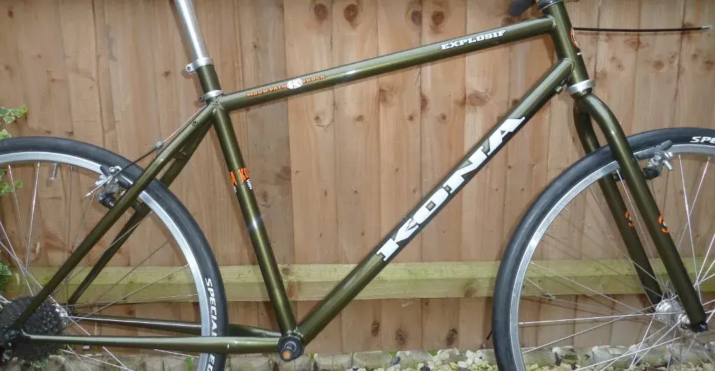

18" E-Bay sale:

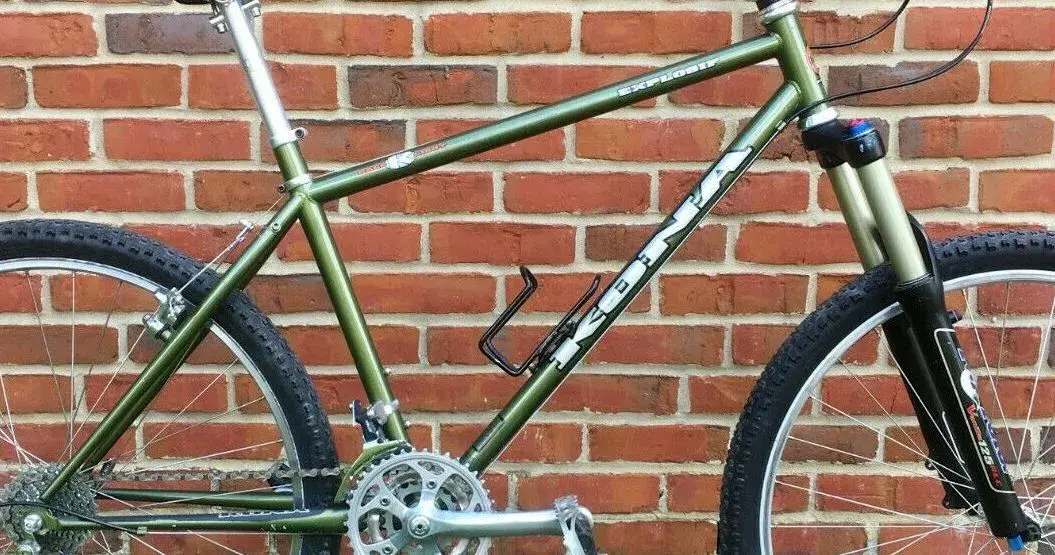

19" from my records:
What's quite interesting is that this bike doesn't have the Fluted Tange Ultrastrong Downtube normally seen on the 1994 Explosif:
