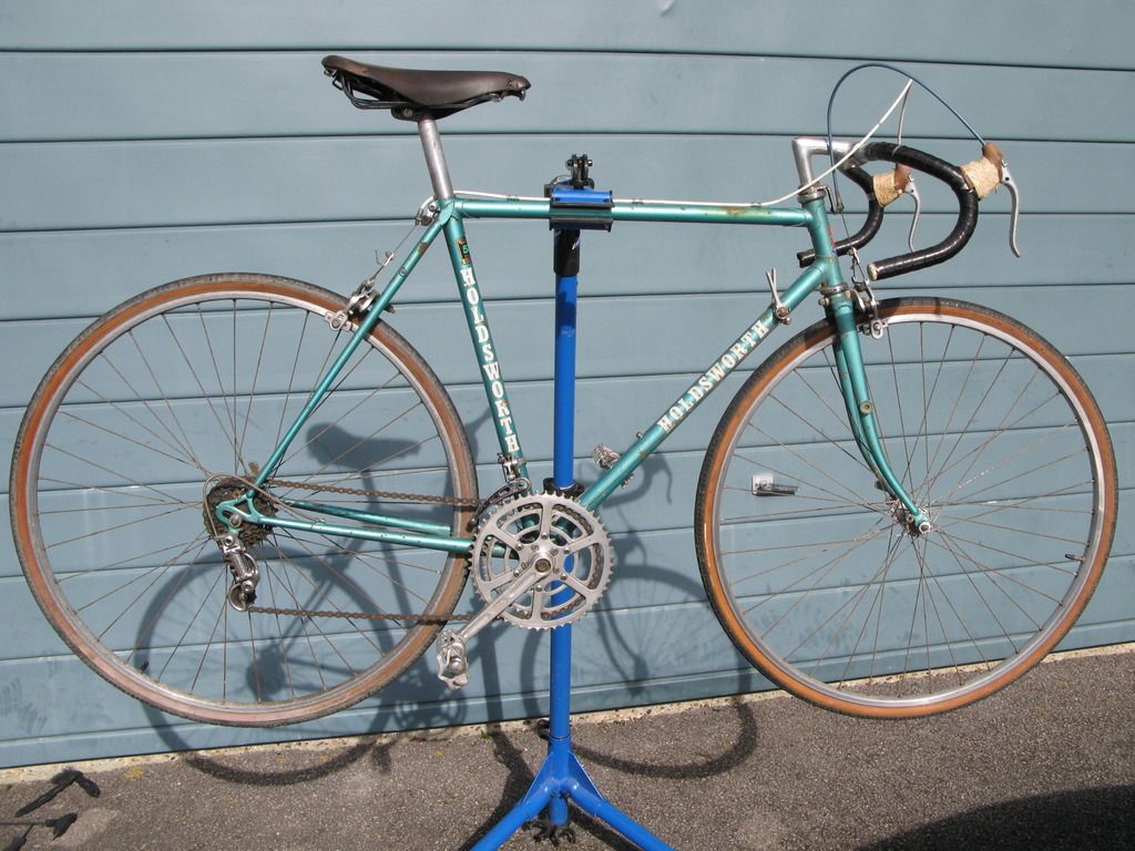

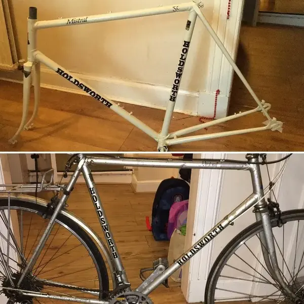

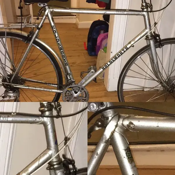

Am attempting my first refurb - well, it's more to learn a bit more about mechanics than refurbing, but while I'm at it, I might add a few bits and maybe spruce up the bike a little bit.
Bike's a Holdsworth Mistral. I've dated it to 1980 and I got it for £ 25 a couple of weeks back (wife thinks I paid £ 26 too much for it...). It has been used as a touring bike, which is what I'd like to use it for.
I don't know how many components are original, if any. The groupset is a mix -
Deore MT-60 cranks / BioPace triple
SunRace FD
Shimano Capreo RD
Hubs are early Deore from what i can find
Gran Compe centre pull calipers
Bars and stem are fairly recent, generic sit up and beg hybrid bars.
Rims... was told they were 27", yet to take a proper look, but 700c tyres on them
So what to do with it as a first project...
I suppose I don't know what it would typcially have been kitted with. It would be nice to fit something in keeping with the time - it already some early Deore, so maybe continue along those lines?
Do I want to go with full Campag? I don't think it would have had high-end fittings and TBH given the original reasons for buying the bike - learning a bit and having a bash - I'm not sure I'd go for something at the higher end of the scale.
Would be interesting to hear about options for the bars and stem. If I was going to do one thing with it, would it be going back to drops? Or are there other options?
I'd appreciate if any of you had any ideas or opinions on what direction I should take.
In the meantime, I'll keep busy applying some elbow grease...
Thanks very much
MM

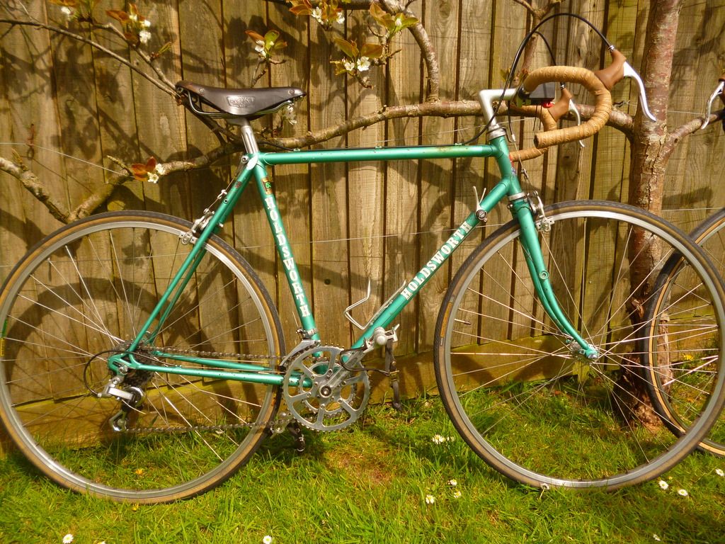

Hi, I picked mine up at auction for £90 so you can tell her indoors you got a bargain. Think mine is slightly later as it has braze on bosses for a pannier rack and a lamp boss. Did have the original 27inch wheels with Campag Grand Sport hubs and Mavic Module E rims and Weinmann centre pull brakes.
I have taken it back to touring spec and it has proved to be a very comfortable ride, even with 25mm tyres on gravel and bumpy tow paths.
Here's a few pics and look forward to seeing your build..Tim.
In as found condition.
After a few upgrades.
On a retro pub ride.
Full touring mode.

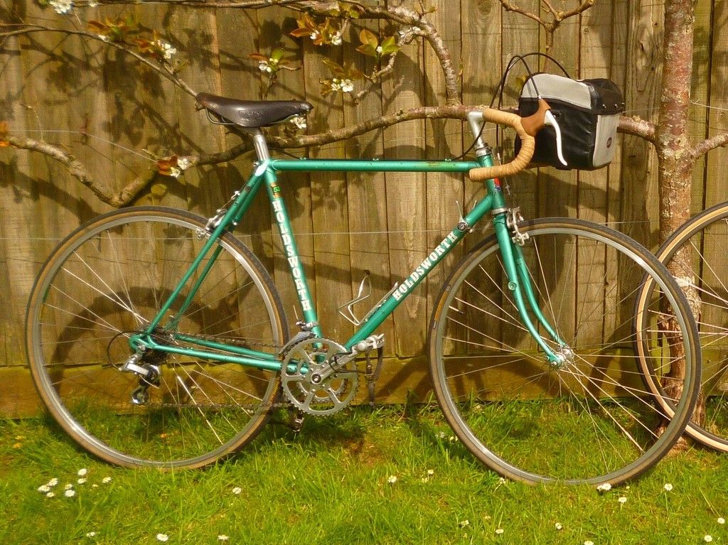

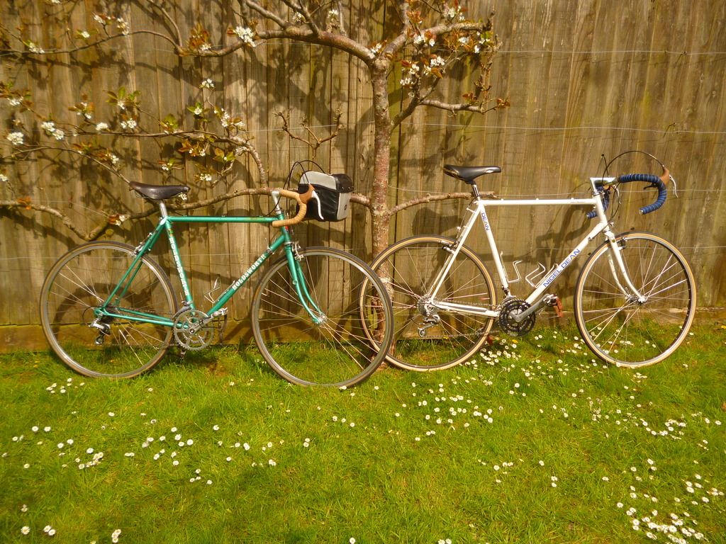

Hi folks
Have been offline for a while, but have got a bit of an update for you.
Have made some progress. Also have hit a couple of stumbling blocks, but I'm not going to get too hung up on them just yet.
On the plus side, bike has a new coat & decals and it has come out really nicely.
Have also sourced a couple of more original bits - it originally had parts from late 80's and mid 90's.
So a Suntour rear deraileur, gear levers, SR cranks, leotard pedals, cinelli stem and bars.
Have had problems with the Mavic 630 rims. I can not for the life of me get tyres to sit in them. It's as if the tyres are too big. Have tried semi-inflating, ties etc., but no joy. So for now, am parking the hubs and rims that came with it and I'm putting on a set of modern 700 rims from my road bike. Not ideal, but it will allow me to move on. Also, the Cinelli headset and bars came with Dia-compe aero brake levers. Purist in me wants to use non-aero, but given this was originally supposed to be an exercise in learning about bike mechanics, then I think I'll stick with them and maybe at some point in the future I'll chance upon some levers that I can swap over (originally had MTB bars and a long stem fitted). Same thing for the rims/tyres.
So... it's coming along, just need to piece it back together again.
Will keep you posted
Gerry
