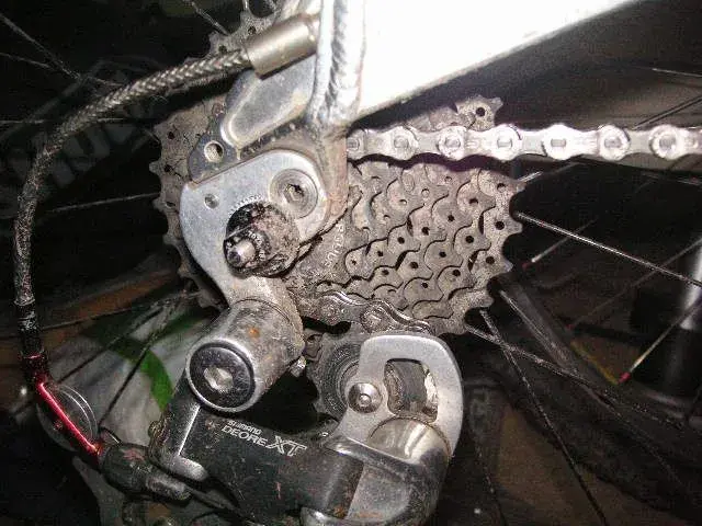

Cable outers! Just saw the photo and realised the biggest cause of " mystery skip " is too-short cable outers. Check them too.

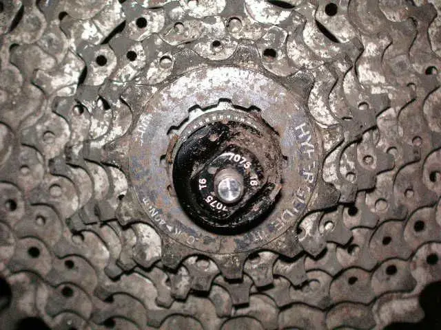

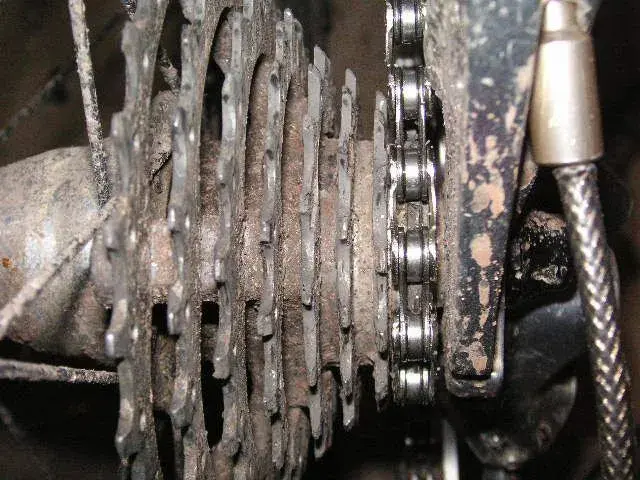

Closer picks of the mech and cassette. Couple of things. I disconncected the cable inner, to check if it was the outer causing the problems. Just the same. The front rings are brand new. This cassette was brand new from chain reaction, does it look worn to anyone?
The BB may be a little narrow, causing the angle of the chain to be a little high, but it skips even when I put it in big ring. Got to original XT mech back on now to see if that makes any difference. Looks to me like it has to be the cassette. Thanks for the help everyone! :)
