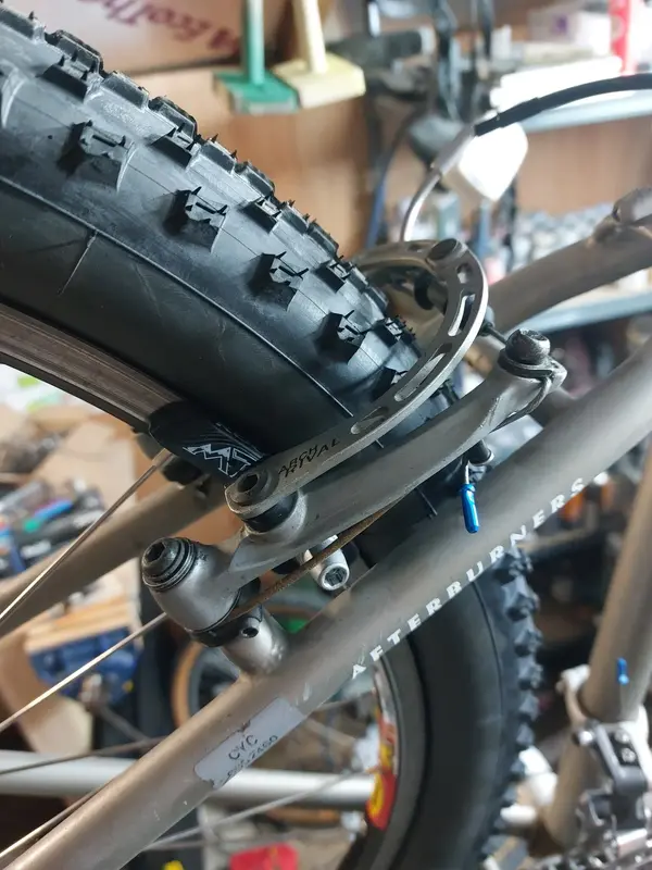

I just encountered both these issues with my Sbike. Fortunately I had a correct size (3mm) spacer and I swapped the Miche lockring for a shallower SRAM one that was kicking about and it's all good now.
Avid arch rivals are pretty good things.
