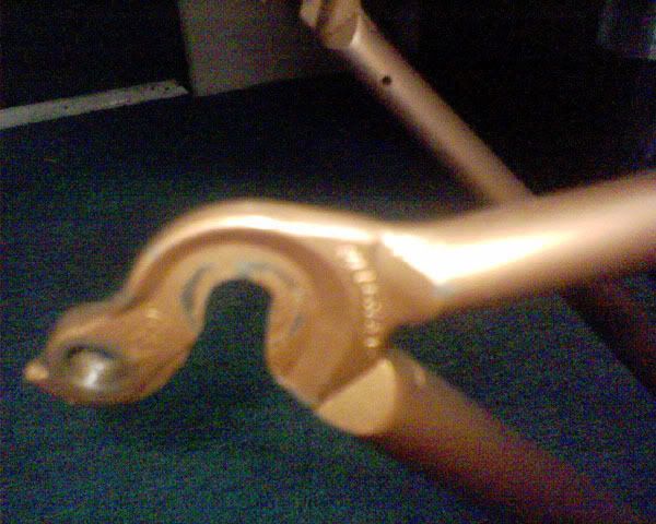

Ritchey cast vertical dropouts fillet brazed to the stays with a "TR" logo stamped at the derailleur hanger.

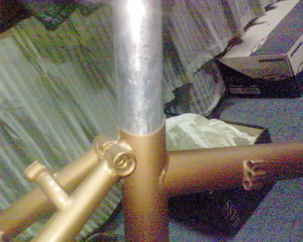

Most ritcheys' I've seen pictures of had the seat stays welded to the junction of the seat tube which also acted as the fastener for the seat post. It had a cantilever brake hanger.

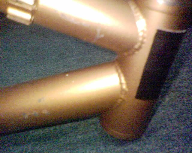

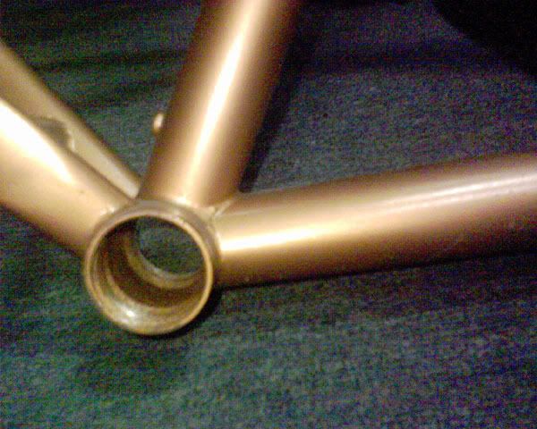

The bottom bracket is pretty standard and it had the serial number stamped on the left (non-drive side). Particularly interesting note is that the down tube was ovalized at both ends.
The joints for everything seem to be TIG or electrode welding except for the dropouts and are very neat and even.
What makes me doubt however if this is a ritchey is that most of the ritcheys I saw had top cable routing for the brakes and bottom cable routing for the shifters but my frame has drive-side top tube mounted cable routing
The closest visual identification I got was that of an old scott frame (after all a lot of good bikes used ritchey dropputs) but the seat stay/seat tube junction did not match up.

About a month or so ago a member from Poland showed something with some resemblance. I concluded it could be a Bike Tech. Bike Techs were made by Toyo. Toyo made the Ritcheys too. It could be yours is Toyo made as well, but I do not know what make or model.

To me there is quite a lot resemblance with a BikeTech (incl seatpost size), but with Ritchey stays (another product by the Toyo shop).
Moreover the Parkpres don't match exactly too.

Thank you for your input I looked at the catalog in the link you provided an it does seem closer to the bike tech frames than it is to the parkpre, I recall from some old bicycling magazines I had that very few frame manufacturers used the side of the top-tube for cable routing. Thank you, your input is of great help!

I too first thought it was but when I flipped through some of my older magazines (1992-1998) subscriptions the Parkpres' did not match when it came to seat tube diameter.
