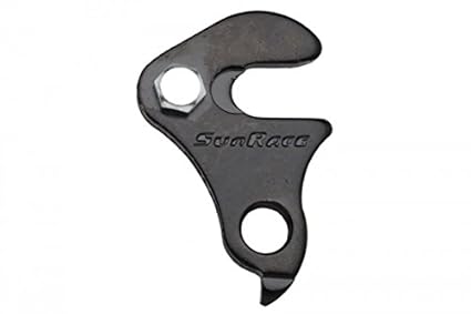

The problem as I see it is that I have no hole through which to bolt to prevent the hanger rotating.
The original hanger was fixed in place by a clamp nut and bolt around the outside of the frame. With the 10sp cassette there is now no room for the captive nut. I think I need to either spread the frame wider and fit a spacer to allow use of the nut, drill and tap the frame to allow me to bolt directly to the frame or get a hanger that somehow doesn't allow rotation.
Again, any suggestions gratefully received.

The dropout looks somewhat spread open?
The mech hanger bolts to the dropout with a special nut / bolt that engages the dropout slot itself, The mech hanger usually has two raised studs / rails on the back which lock into the dropout slot to prevent rotation. You could always drill a small hole in the dropout and use a self tapper to hold the mech hanger in place. The nut holding the wheel in place actually does most to keep the mech hanger there.
Shaun
Many thanks Shaun. I've ordered a hanger and I'll make it fit. It's nice to just double check that I'm on the right track with people who know sometimes.
