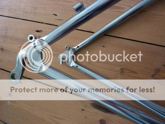

No reason why not, mine was in a similar if not worse state -
**EDIT - in fact looking closer at your pics, should be straightforward, can't see any obvious issues there, nickel looks fine underneath the tatty lacquer**
Scrub off the lacquer taking the rust off with it, Autosol the hell out of it, get the Turtle Wax on it, then get someone to re-lacquer it (in my case, C&G Finishes in Liverpool) topped with new decals from Gil.
Once the lacquer's on you can't obviously polish the frame any further so get it as shiny as you can as the lacquer coat will make it look a bit duller anyway.
(As for uploading pics, I just upload images to photobucket then click on the "IMG Code" option then copy/paste it on to your post)
Many thanks. I'm scrubbing the hell out of it right now and it's actually putting a big smile on my face watching it shine up :) pics to follow

Ta...
Decals from member gil_m on here.
They resparayed my forks/stem as well as a couple of other things, so not sure on the precise amount for just lacquering - perhaps 25-40gbp-ish, dunno....? Someone will be able to tell you, however.
