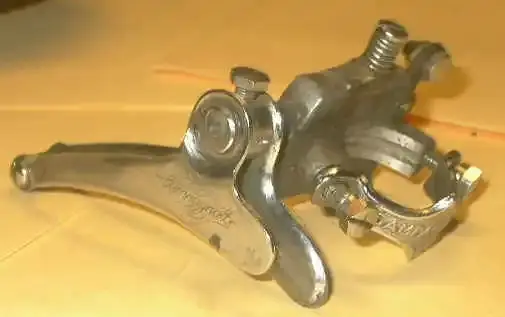

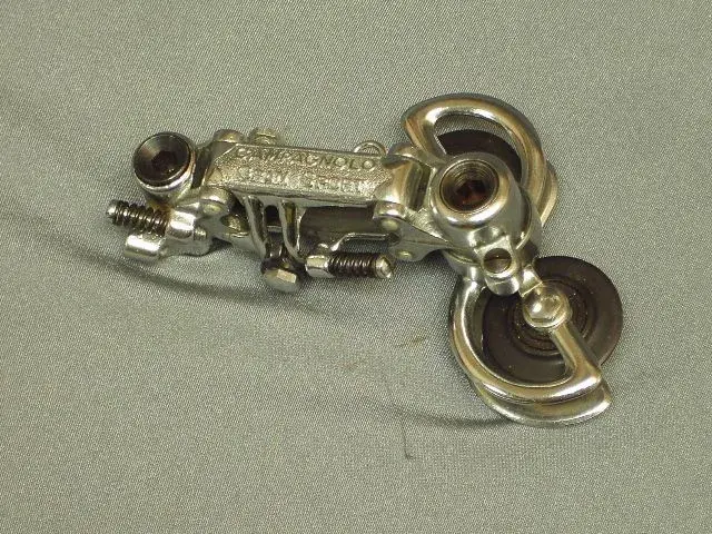

Ok all joking aside this is a pretty amazing find. Like I said above keeping it original will be the best plan. Looks to be mostly original the only exception being the rear mech which was replaced in the '70s to '80s. Looks like the shifters were replaced as well and clearly the front mech is missing. If you wanted to go with Campagnolo then appropriate equipment might look like this:

I thought the mech and lever were 70s. Those early Simplex ones look the part but I don't think I would want to ride with them. The Gran Sport is nice and I was thinking of trying those. There is a single braze on for a lever. No sign of any front mech ever having been fitted. The Simplex double is a 50-48 or 47, not sure if I lost count. The rivets for this have been just kissing the chainstay for a long time, just cutting through the paint. Would this be a stop and change it or a reach down and try not to cut your fingers off move? There is no deraillieur hanger on this frame but the base of the dropout looks as if it has been fettled in some way. Would a 50s deraillieur like the Simplex have mounted with an adaptor or directly to a braze on or an integral part of the dropout? Colour is odd - Its blue again in my garage but looked purple at work!

As for the gears, I don't know but I have a couple of Gran Sport rear mechs and they are very nice.

I guess early to mid 1950s. Probably 47 x 50 Simplex chainrings, this would give 10 evenly spaced gears. Nothing wrong or dangerous with the early front changers. Simplex made one that I could change up with the inside of my leg.

If the rear ends have been 'fettled' then in all probability they are Simplex ones which were quite specific for fitting early Simplex mechs. This is possibly why they have had the hanger part cut off, a common thing done to 'improve' the frame BITD. As I said above, if this is the case then the gear lever boss will also be a Simplex one which again is quite specific for a Simplex lever. With no left hand lever boss the front changer - if fitted - would have been a rod operated one like this -
