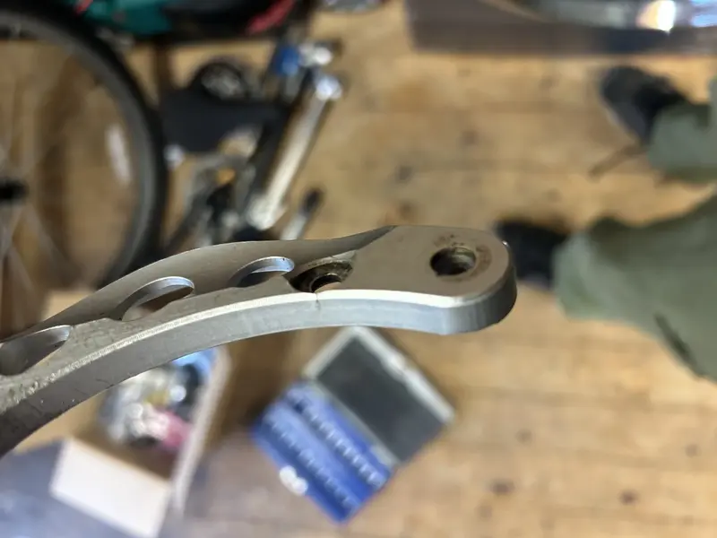

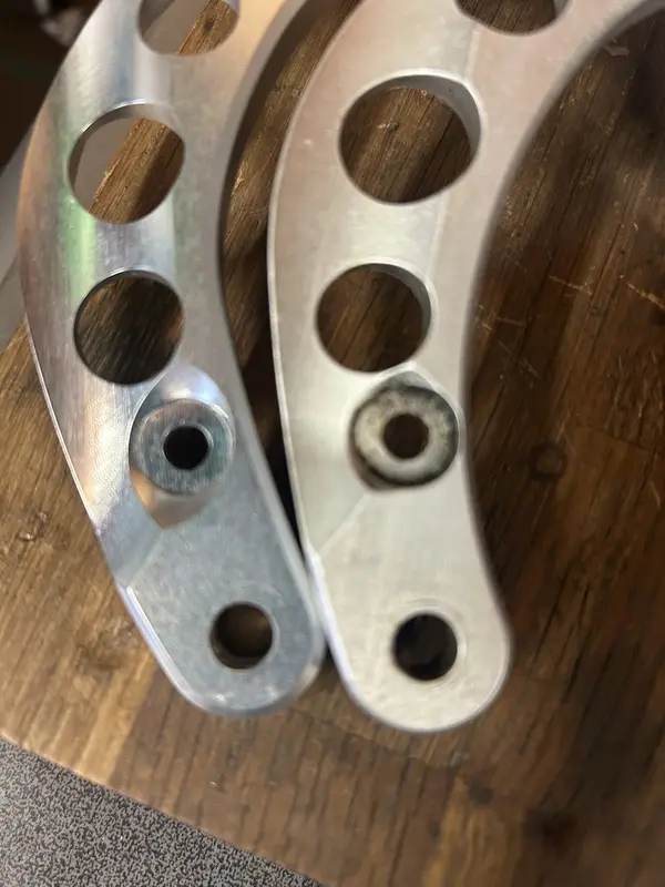

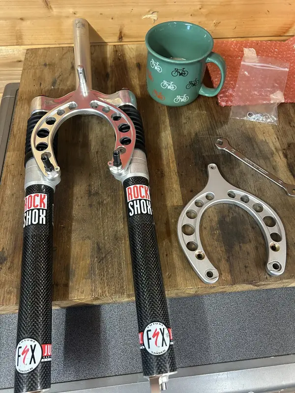

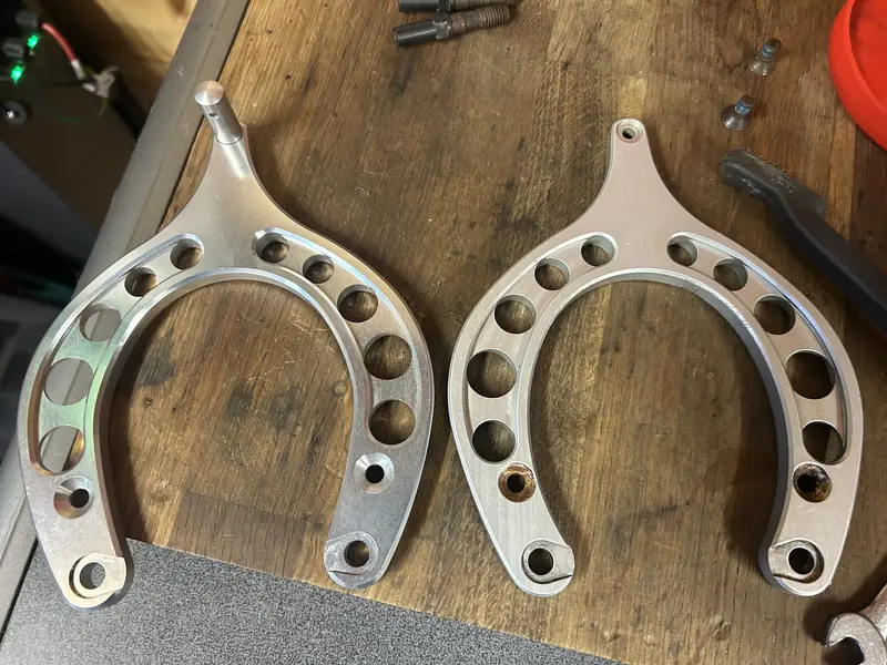

The original RockShox FSX brace has a small crack on the drive side where the Allen bolt goes, a known issue. It was only small and I thought I’d live with it but I needed the missing hanger and when I saw one of the US repro made ones in the UK for sale much cheaper than the new price, I grabbed it.
You can see they added a bit more meat to stop this happening again on the repros.
Now just need to add the NOS internals to up the travel and the forks ready 😎

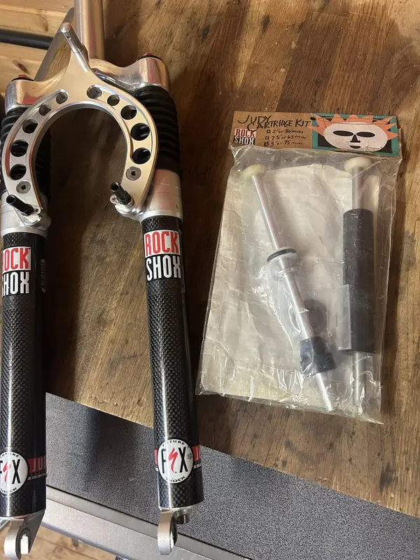

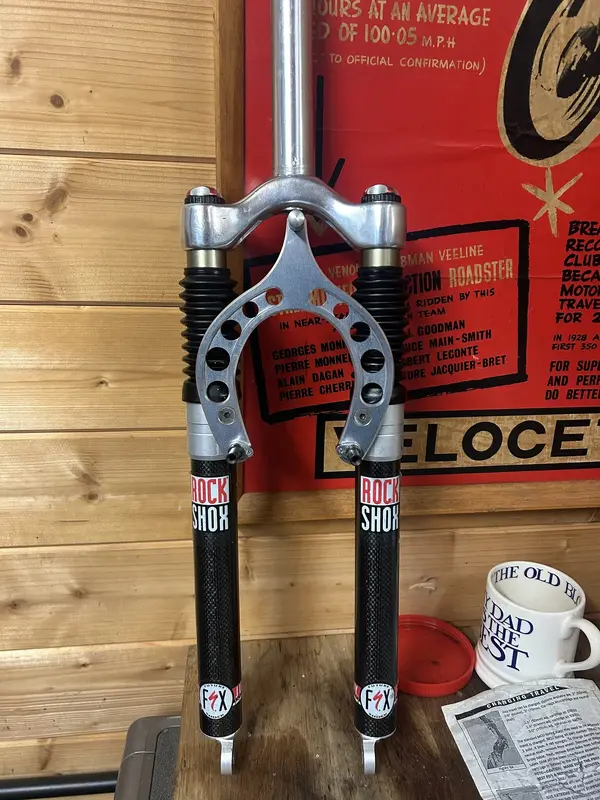

Travel upgraded to 3”. Out with the old, in with the new. Just need some longer (Judy DH or SL long travel) dust boots now:

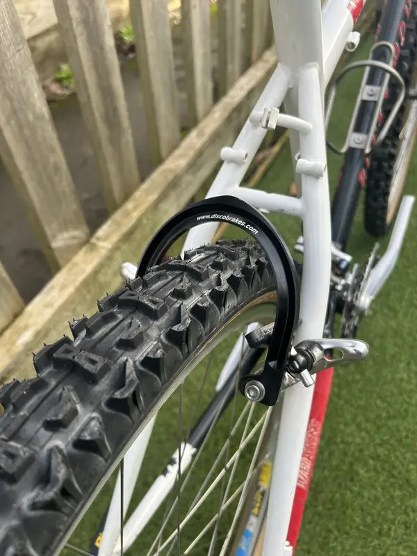

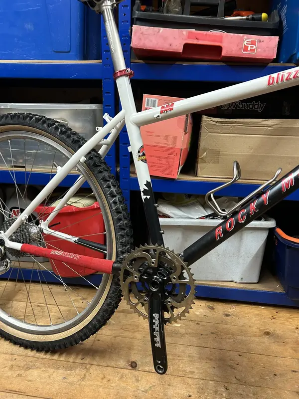

Started the build whilst I’m waiting for some new decals from Gil plus a grannie ring and rear brake booster from a member here.

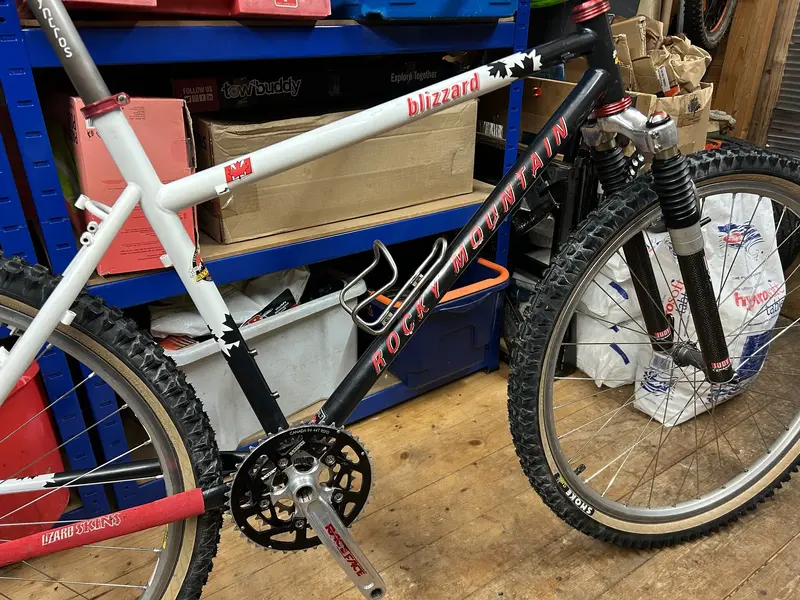

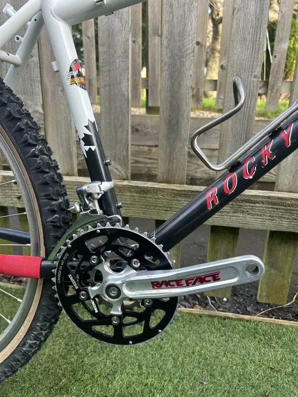

I can’t decide if I prefer the silver cranks with black RaceFace rings or black with bronze rings?

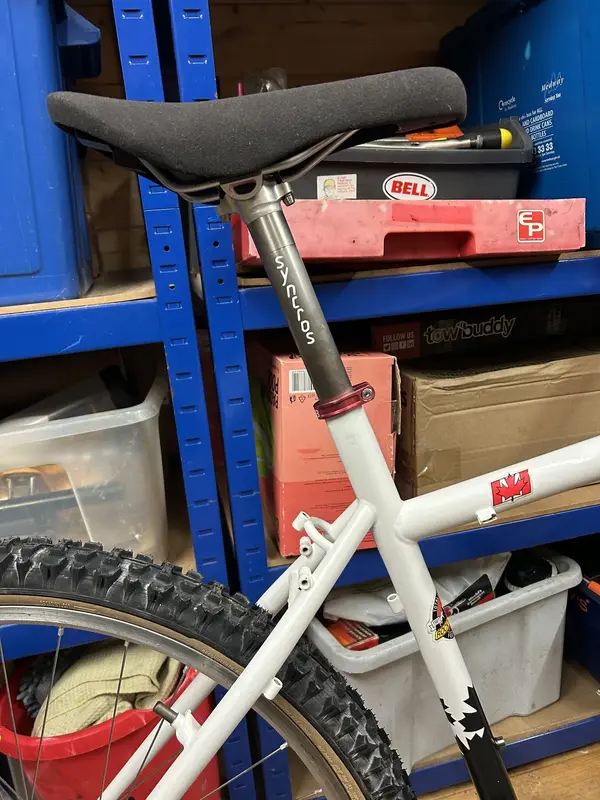

I’ve gone with the Ti Syncros post rather than the black RaceFace XY, I think the bike needs that bit of silver colour hence why I think the silver cranks will work better too with black DMR V12 mag pedals.

Tough choice. The silver with black matches nicely with the Rockshox, but for some reason, I'm still drawn to the black with bronze. It could be that it would look great on MY bike :LOL:
I think the black with bronze looks classier but yes, the silver with black goes nicely with the fork. I’ll keep both until I finally decide them one will be up for sale online with other bits I chose not to fit.

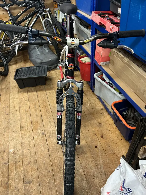

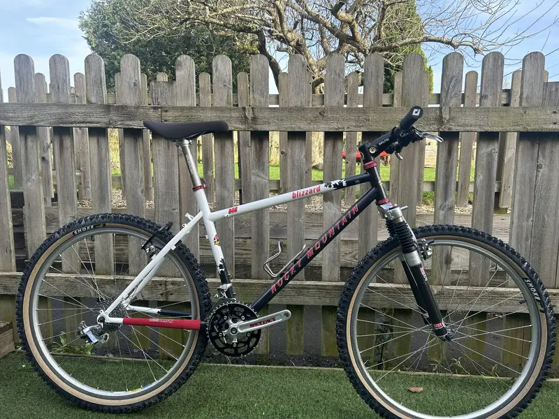

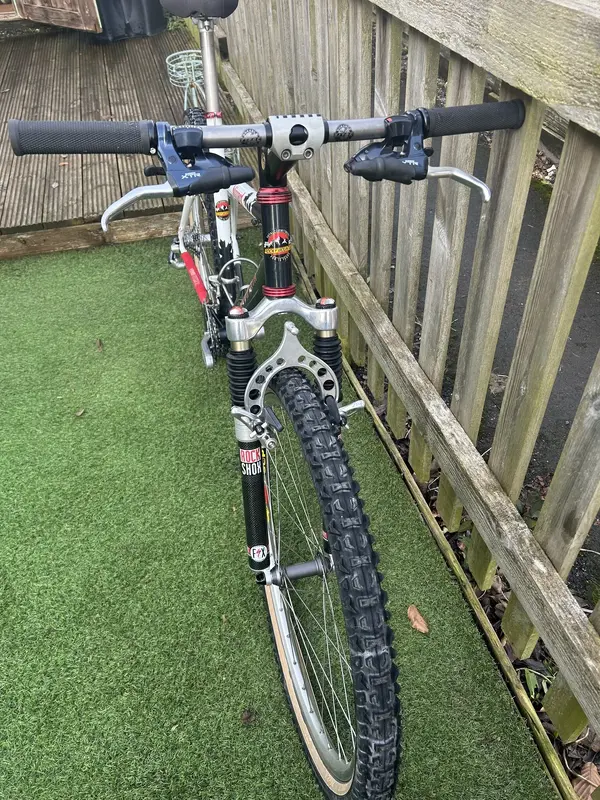

Few updates:
Bars swapped out with some flat Titanium 555mm long ones thanks to member Rambo Mambo, the lovely black brake booster I’ve added to the rear came from him too 👌
I definitely prefer the width of the risers but with this stem shouldn’t need the extra height.
I’ve purchased some alloy expander type bar extenders off of eBay, have seen other members use them here, hope to achieve just enough width to give better control and feel less cramped. Cant believe we used to cut our bars down!!!
Gil came through with a great decal set, I’m just replacing the down tube and top tube main decals. Spot on sizing and colour as always 😎
I’ll put these on then take more pics.
Then just cabling, which I’ll do when the bars are at the chosen width, chain, pedals, setup and ride 🚵‍♂️
