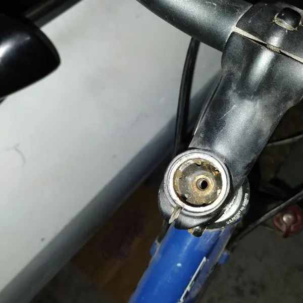

I have new grips ordered. I removed the stem riser adapter and now have a new top cap set coming.

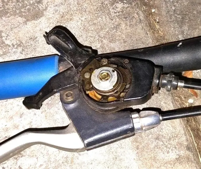

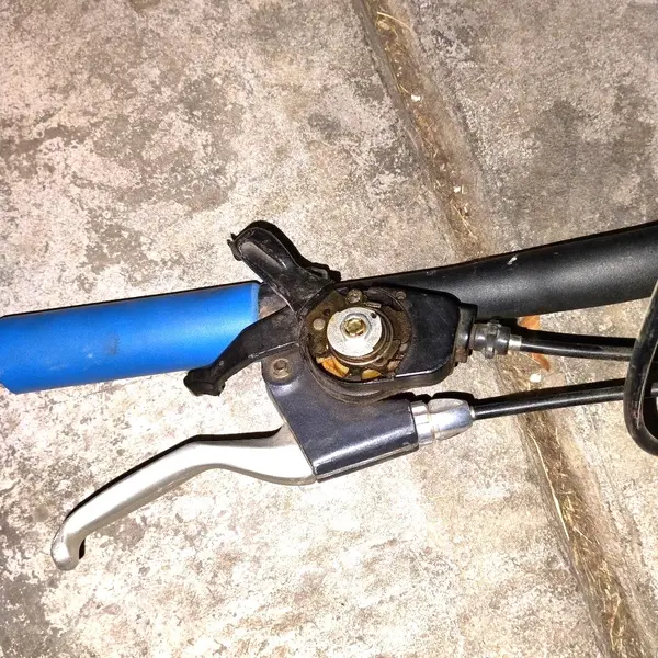

I flipped the bike over and found the bottom cap missing on the FD shifter. 🫤. I think these are Vintage Shimano SL-MC38?
Not going to be messing with the shifters. I could probably spend the time, and a bunch ot cleaner, to maybe get them working again but the time/effort vs cost of new just isn't worth my time.

Tonight I decided to flush out the shifters before placing an order for a new pair. Suprisingly they started working after only a coulple of flushes with WD-40.
I suppose I can run the F/D shifter without a bottom cover with no issues besides aesthetics?

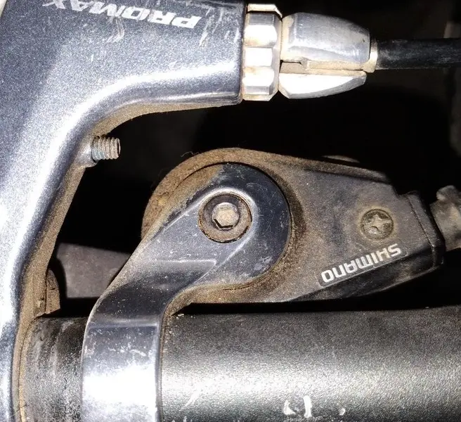

Long shot here. Looking for a bottom cover for my shifter, Shimano SL-MC38. It looks like the STX RC shifter might have the same bottom cover also.

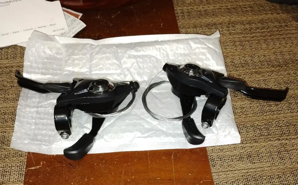

The shifters started acting up again and the cables need replacing so I ordered a set of EF51 shifters. This missing bottom cover was bothering me also. I wanted to keep separate shifter/brake levers but got a great deal on the integrated EF51's.
Waiting game now.

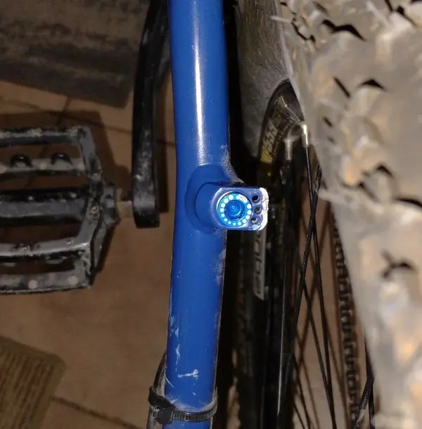

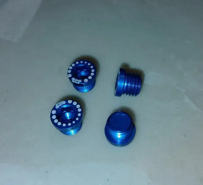

Still waiting on shifters so not much to do. I added a couple of V brake boss plugs to fill those empty holes.
Too bad the ones on the RS Psylo are smaller (M8?).

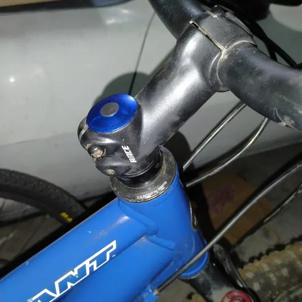

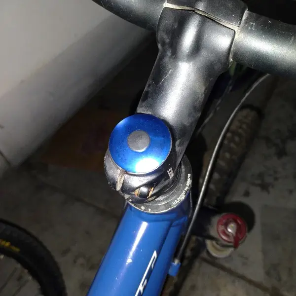

Got the top cap installed too.
