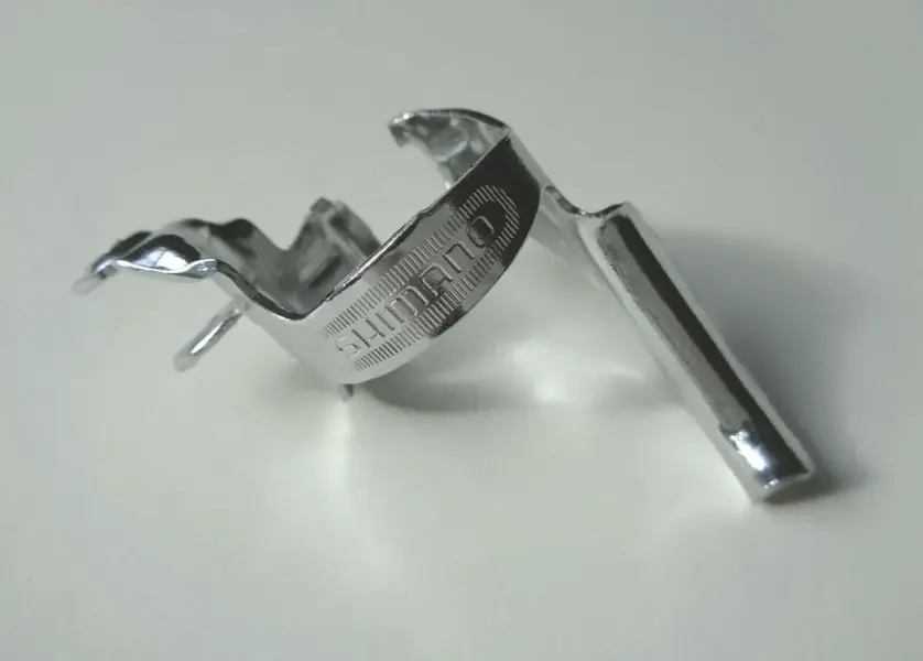

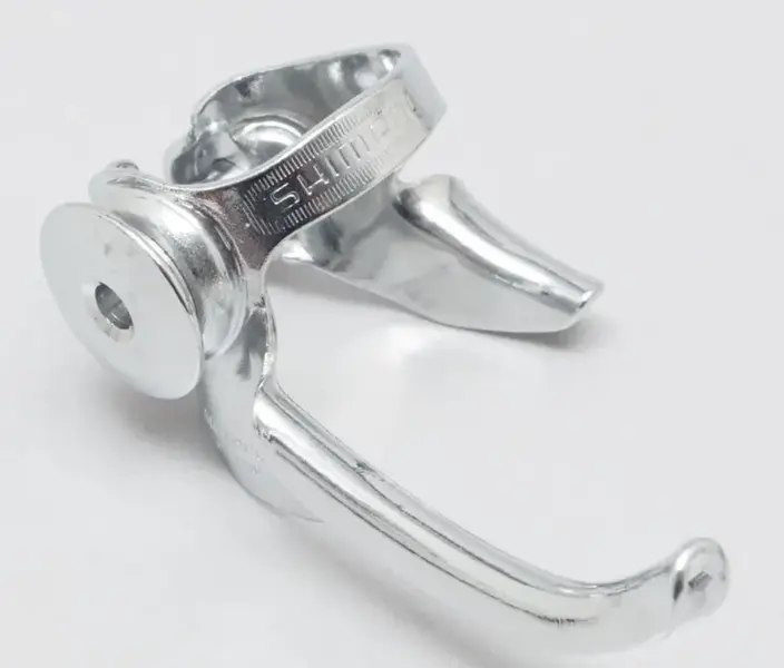

The single guides I’ve seen all seem to be right sided, so I presume they are just for the rear mech on a 5 or 6 speed bike? So am I going to need the cool looking double as pictured? The frame does have cable stops on the down tube so I was hoping I wouldn’t need to use a guide.

Does it have stops on the left side of the down tube as well? If so you won't need the above.

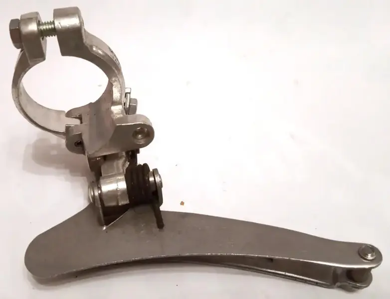

First pic you posted is for a bare cable front mech. Second pic is for a front mech that has an outer cable stop built in, pic below shows the built in stop. Can we see a pic of the down tube nearest the bottom bracket on both sides please?

You won't need guides, just outer cable. You will need a front mech with an outer cable stop though. Yes you can remove the secondary lever, it will leave a stub sticking out. Check for a small spring in the hole, often lost. You will need to adjust your brake cables after.

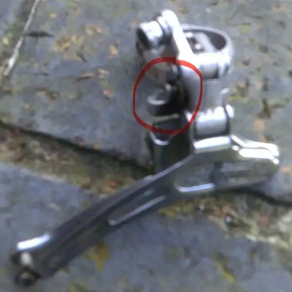

That’s good to know, thanks. This was an additional image the seller of my derailleur set sent me, the quality isn’t great but It looks like a cable stop in the area I’ve ringed in red. Please tell me that’s a cable stop 🤣
