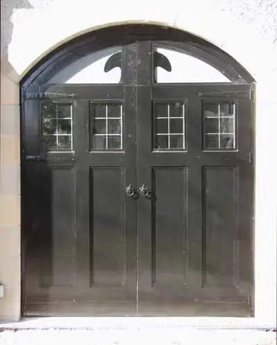

Something like this pair I made for a friend :D
Could make a wee façade for the corners :wink: change the appearance not space.
Now THAT is cool! 8) 8)
Top work Mr Ti :wink:
