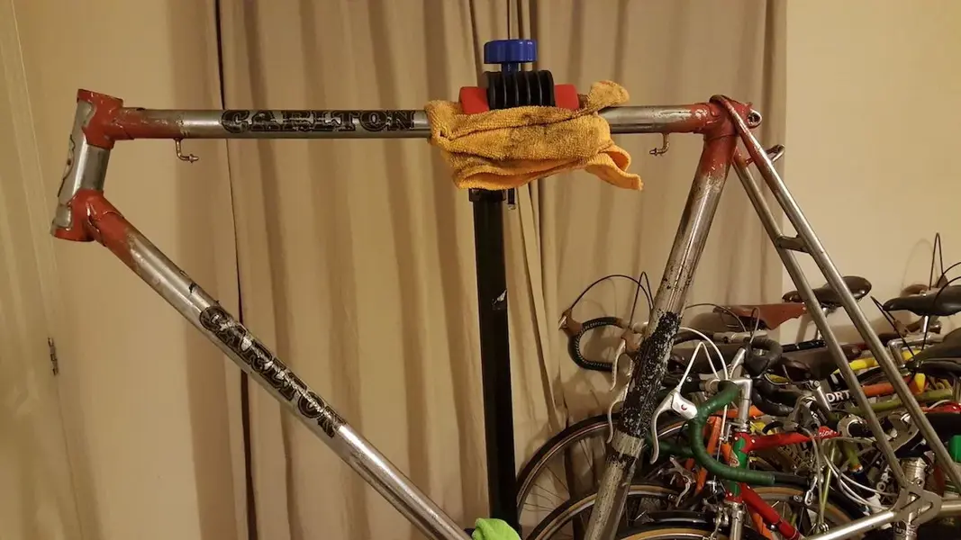

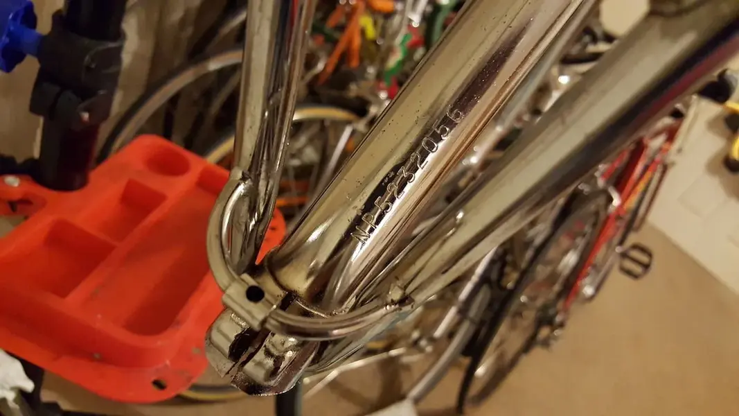

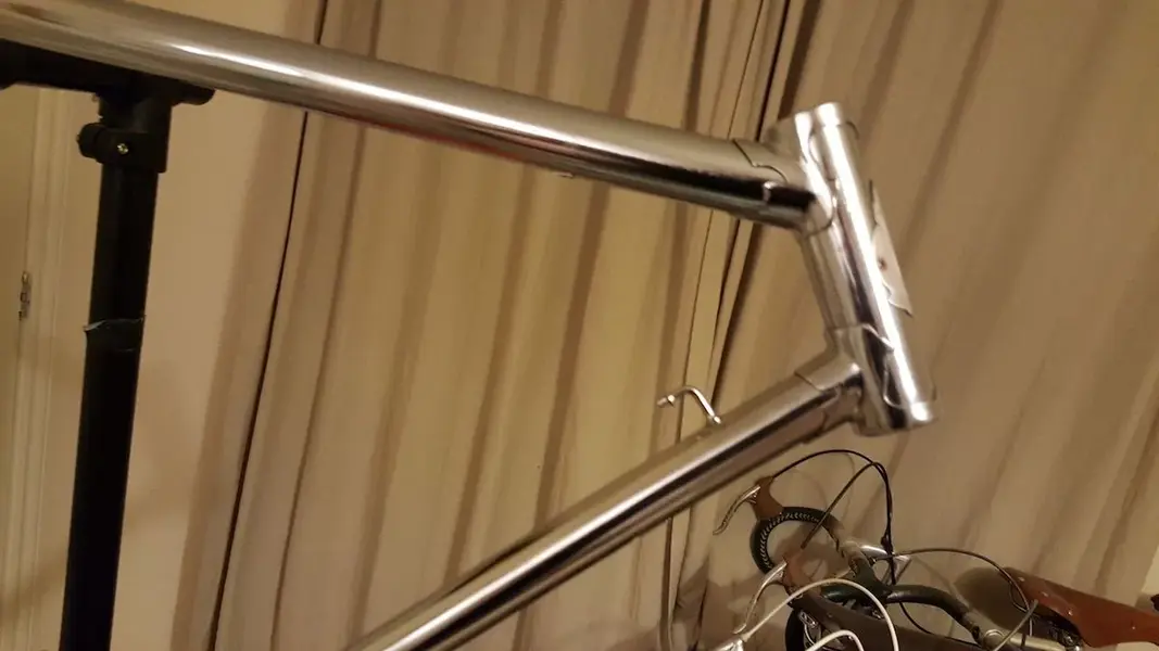

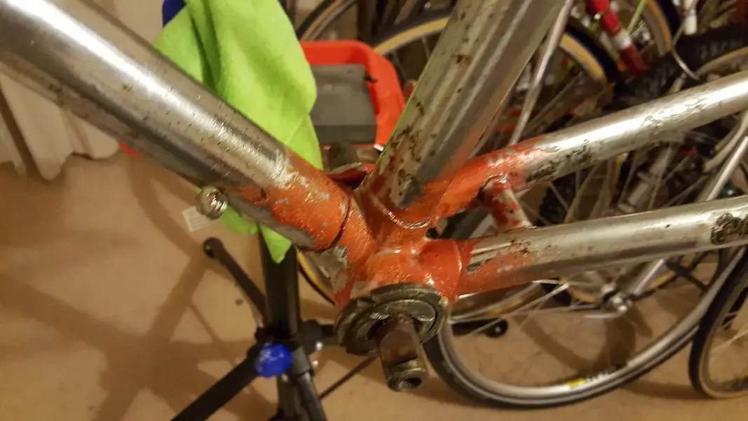

Been after a 22" Carlton Cobra for ages, found this in poor condition and purchased for £21. Stripped down and thrown away most of components apart from frame and a few other bits. Chemically stripped the whole frame, removing all decals and paint. Current state is after 5-6 metres of tin foil and vinegar/water mix. New decals purchased and about to begin with 2 or 3 sessions of Autosol.

Tin foil and vinegar??? Looks like it works a charm on Chrome, how do you do it?
Re: New Build - Carlton Cobra
The method and science is here: http://www.robertscycle.com/chrome-clean.html
The addition of something acidy to the water i.e. lemon juice, vinegar or diet coke is also well documented. The slightly acidic flavour of the water enhances the reaction between the tin foil and rust which removes the rust spots. As long as the chrome isn't flaking off it works pretty well. In this case the rust spots were fairly extensive so, even now, there are some tiny little holes in the chrome where the rust developed, but the rust itself is gone and some regular waxing will prevent it returning.
Autosol is the final stage, which itself protects against rust and gives a glorious shine.
