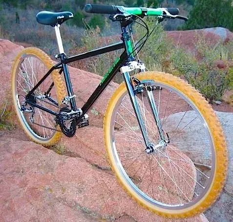

This one is a small size for my gal. She is 4'10" and 90 pounds. Rides on the bike path most of the time (you may know the type). She has the Monster Fat I built up for the trails I take her on, so not too concerned about the strength of the gusset, per se. I have my Yetis to ride hard, so I wont sneak out on her Defiant... like I do her Monster. :wink:
Her other bike (with slick rock tires mounted)...

That Monster Fat looks wicked, those forks suit it so well.
