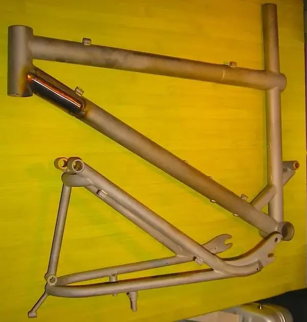

Here is my latest project.... found it in the garbage somewhere.

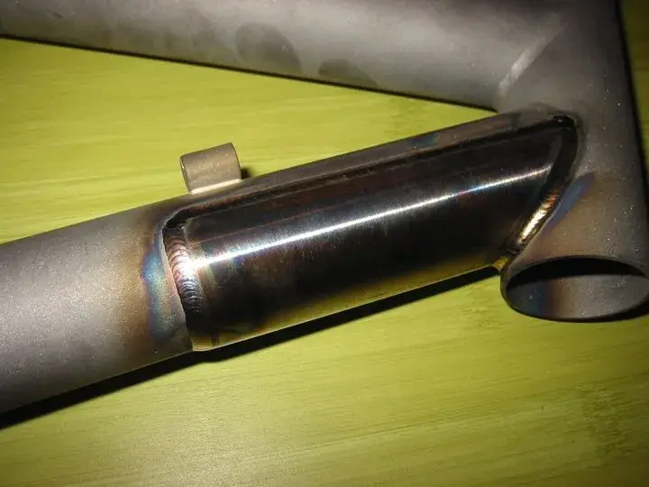

I have made some progress, finally. Had it media blasted. Uncovered a pretty nasty dent near the top of the down tube. So, I had my friendly neighborhood frame builder (Eric Barr of Groundup Design) put a gusset on there. I think it will be O.K. even if it isn't original??
The shock is at Risse Racing for a rebuild. It goes to powder next week.... color will be decided when I get to Spectrum Powderworks. (I am not the type to be stressed over it being an original color).
Gil for decals? I hope he can do them, or has done them in the past...
And, now back to your regularly scheduled forum. Cheers.

These are so beautiful!! Just missed out on a Defiant Ti earlier in the year on fleabay, and still gutted about it... :(

Gussets of that type should always have the bottom of the plate unwelded Keith Bontrager would have a dicky fit if he saw that.
ATB
John
I think it can go either way. Un-welded portion of gusset, or weep hole in down tube under the gusset.
Out of the oven this week, hopefully. Decals from Gil next week, Lord willing.
Picked a colour yet Luke?
I'm dreaming of a white Christmas. :wink:
I would try the bottom bearing cup from the headset in the frame to make sure the welding hasn't sent head tube out of round before sending for coating.
Looks a nice job, and a great find.
