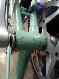

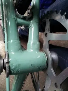

Keith - The dents under the bottom bracket lugs look like small round punch marks, there is also another frame/part number stamped in. Does this sound like what you have described? I can post a pic of this tomorrow.
Here are a couple of pics of the underside of the bottom bracket. The stamped frame/part code reads G.R. 23B.

Looks like BSA, the dents normally larger, but part filled in with the paint I think.
Also may be under the bottom head lug.

If you take the bottom bracket bearings out you should see no pins.
The frame tubes were not mitred, just a single angled straight cut, which needs longish lugs. The french were able to use better looking lugs by making 2 straight cuts on the end of the frame tubes.
