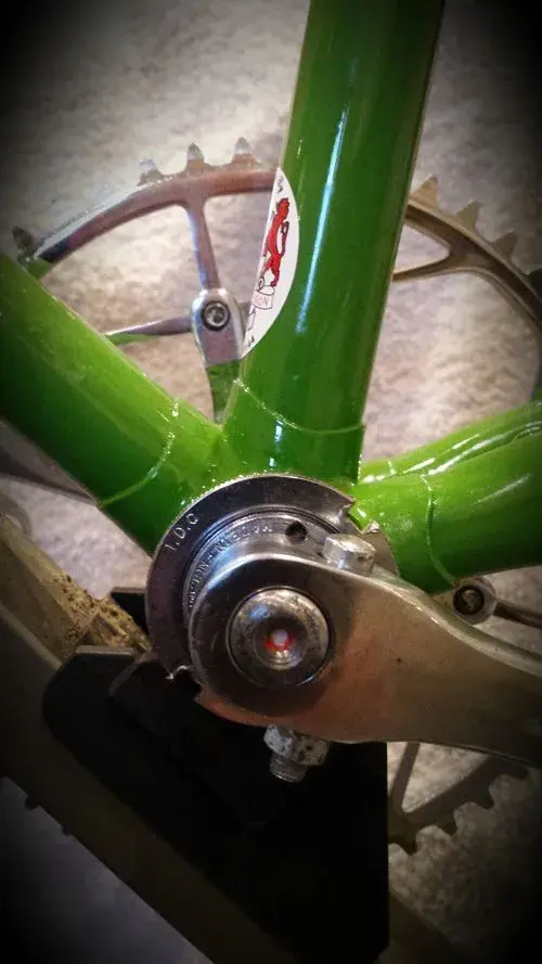

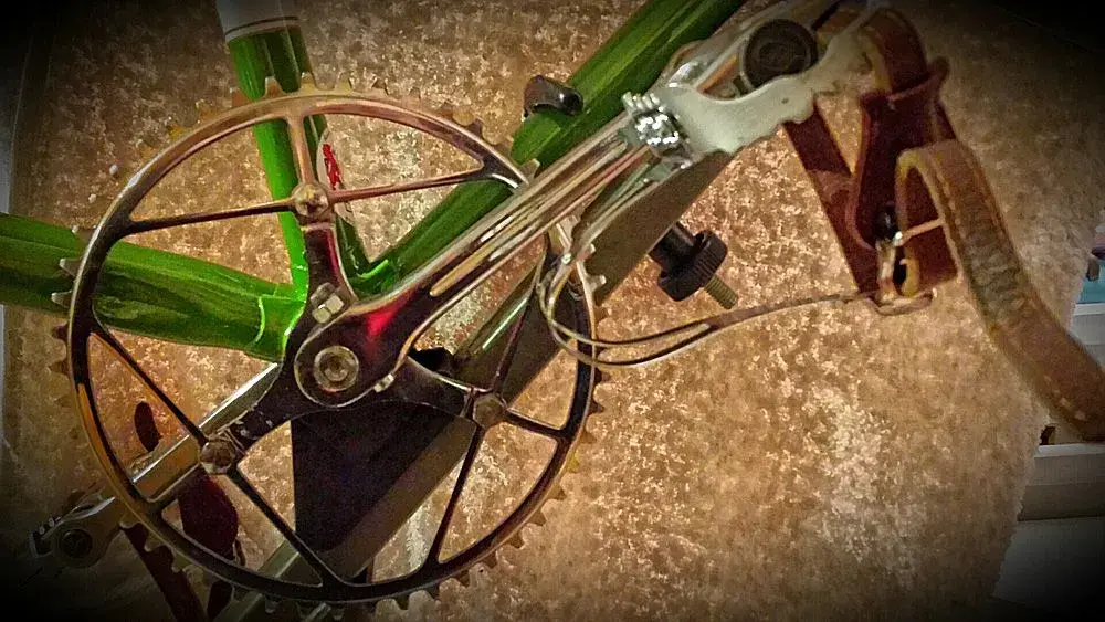

New bearings installed and it took me about 15 goes to get the correct tightness on the bottom bracket but got there in the end. Feels really smooth now with no play. Thank for your help chaps, MUCH appreciated.
That looks smart : . Cup and cone btom bracket are a bit of trial and error! Nice to see you have got the cotter pins in the right way, crank parallel to the chain stay when dropping them in :)
Shaun

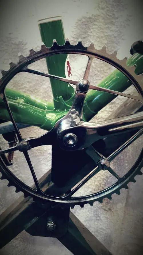

keithglos":zwayh97i said:
The chainring looks backwards to me, or inside out?
I have just looked back at the original photos I took when I bought the bike and I think you're right. I'll check it out. Thanks for pointing that out! I'll get something right first time before I finish this build.
Bob
Yes, that looks better. Thankfully it was an easy fix and didn't involve removing the cranks AGAIN - phew!
Thank you
Bob
