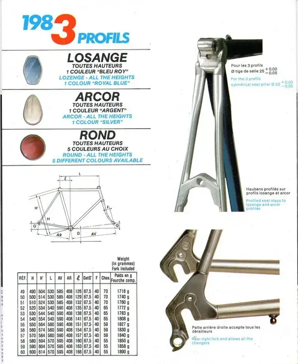

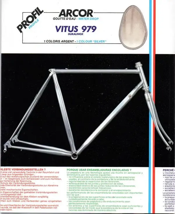

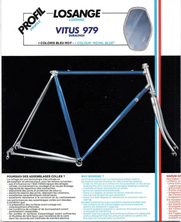

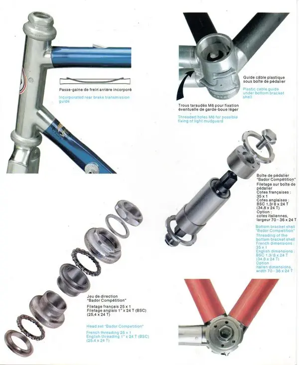

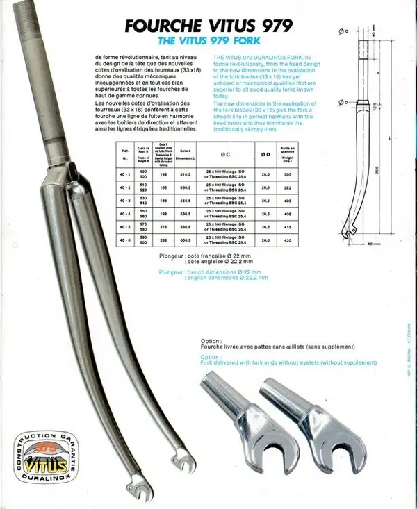

Better late than never! In January I promised a catalgue scan - but I didn't find it where I thought it was. This morning, looking for something else - guess what turned up! So here we are, 1983 and all that, in glorious colour and a variety of tube shapes from which to select.
Interesting to note that the 'shapes' were only available in one specific colour and the colour 'chart' doesn't include the Peugeot 'Champagne' shade that mine is finished in.
