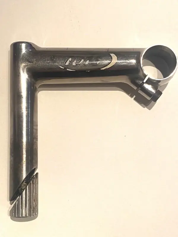

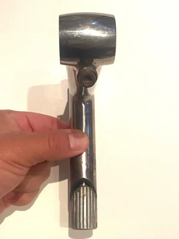

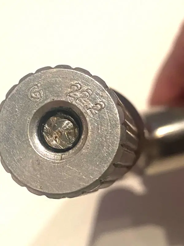

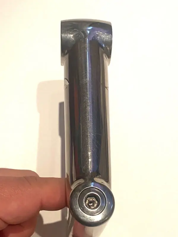

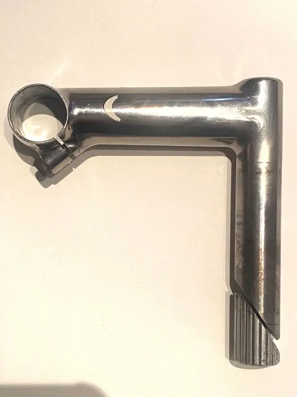

currently im looking for a ibis quill mountain stem and someone had offered me a ibis quill stem, but unfortunately the seller doesnt know wheter its a mountain or road quill stem.. here attached the detail picts of it..
since the mountain and road stem are look almost identical for my rookie eyes, so really need your help to id these stem..
hope you guys could help me to figure out these matters.. your helps are deeply appreciated...

Looks like 0 degrees, can be used for both. Road usually have a negative angle and mountain a positive one (6 to 15).
Road handlebar have 26 mm grip and mountain 25.4.

That is correct. By the look of the photo of the bar clamp area it certainly looks like an MTB version at 25.4mm.
These are beautiful and pretty rare titanium stems, I have a very similar one.

Yep, mountain version
Also, IMHO one of the nicest stems ever made, too bad it does not incorporate front brake cable support, I have one on my Bianchi MTB
