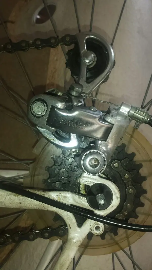

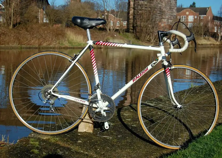

its an old 80's raleigh eclipse 501

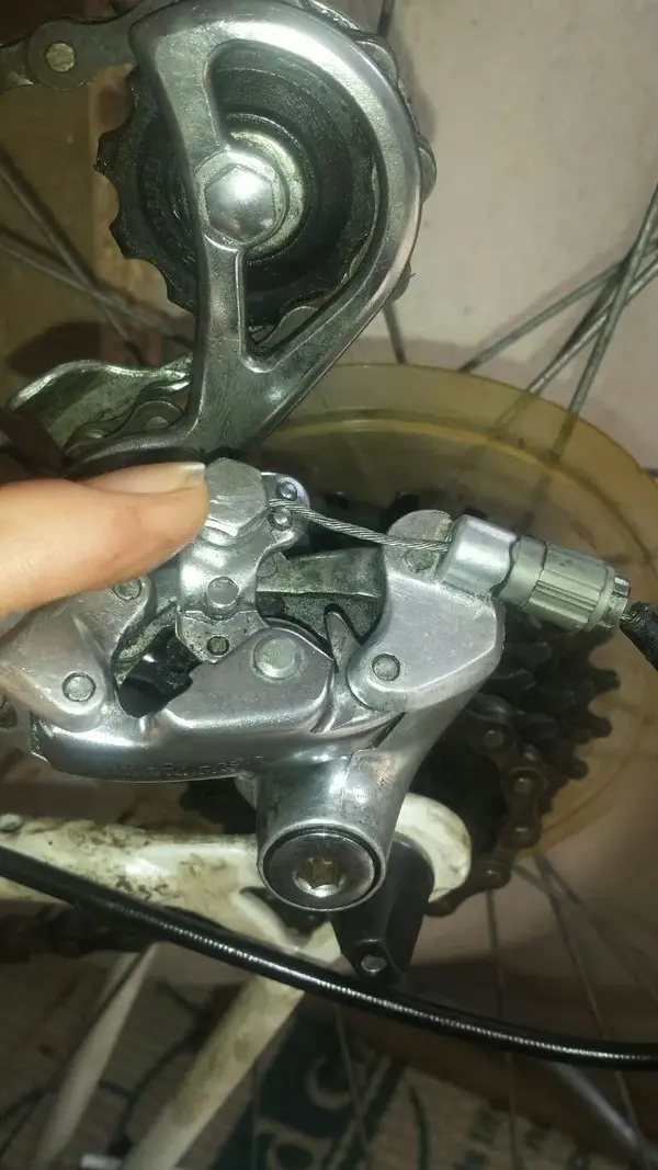

rear derailleur is knackered (the part my fingers on is not springing back anymore/broken) so ill need a replacement or upgrade
been recommended i can upgrade shifters to nicer alloy ones?
cables look frayed and too short
plastic guard between rear hub and spokes could do with replacing
if you could recommend specific parts that are going to work id appreciate it and/or where to buy

I used a Shimano 105 rear mech on my 85 Raleigh Clubman and it worked fine, I may have one here you can have for postage.
I have some alloy shimano downtube shifters somewhere also for postage, I am having a clearout today of the shed, ill let you know.
Re: in need of new rear derailleur cables & shifters
Weren't some of those "light action" derailleurs indexed?
If you're not bothered about indexing then 105 is very nice, especially for just postage!
If your derailleur is adjusted properly you don't need the spoke guard so you could just remove it

I can sort you out with shimano F&R mechs shifters but your better off buying a new chain and cables from ebay or halfords your brake levers look fine and suit the bike
Maybe try looking at veterancycleclublibrary.org.uk for the Raleigh catalogue that has your Eclipse. Not sure of the year but behind the saddle post/seat tube you should have the frame serial number....perhaps beginning N*****. The first digit after the N will be the last number of the year ie. 4 = 84, 7 = 87 etc (I'm guessing it's 80's).
Look up the catalogue for that year and you should have a list of all the original components.
If you're not fussed about keeping it original just type 80's Raleigh components into ebay and go nuts.
Might be worth popping into your local bike shop and saying hello....they may end up becoming good friends!
