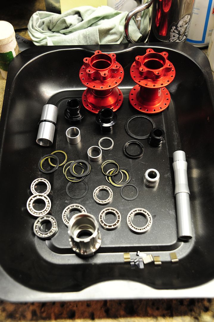

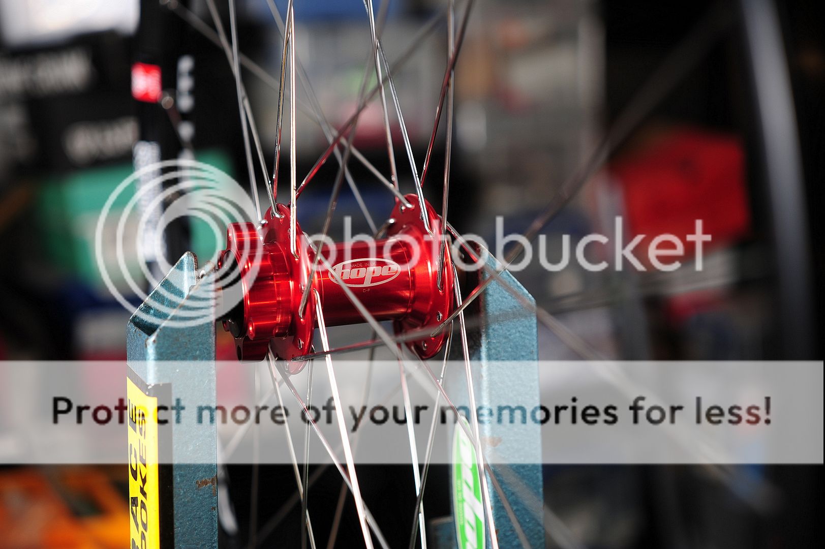

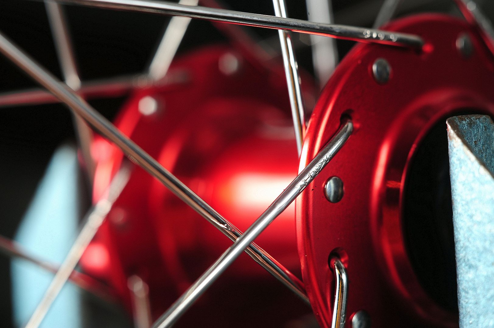

In anticipation of the frame arriving in the next couple of weeks, I have been trying to pass the time productively. Having sold the wheels from the 29er, I really didn't like blue, I ordered a pair of red hubs from the LBS. I had them spec the same stainless steel freehub body as I had on the 29er, I know it should last well.

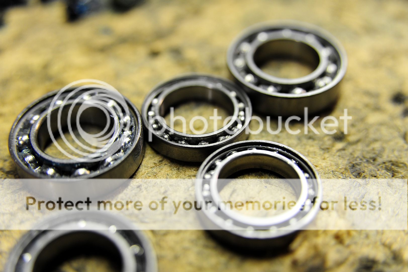

Yesterday, I stripped them down with the aim of re-greasing the bearings. I know the newer Hope bearings don't last as long as the older ones seemed to, and wondered if it was caused by a poor quality grease, or more likely lack of it.
Turns out it's both. It looks like they use a very thin, clear, colourless grease that feels like silicon. In my opinion, it's not heavy enough to lubricate a bearing that is doing such hard work, so I thoroughly cleaned it all out, and added something much thicker.
My favourite grease for hubs is a little known product from Motorex, called 'Grease 2000'. Is mega thick, and is hard to clean off, is waterproof, and is almost too thick for some jobs. I don't have any pics of the grease going in, I didn't want any grease near the camera!
The hubs feel a little sticky now, as you would expect, but are still very smooth. I wonder if hope adding only just enough grease is simply so that they feel smooth when you pull them from the box?

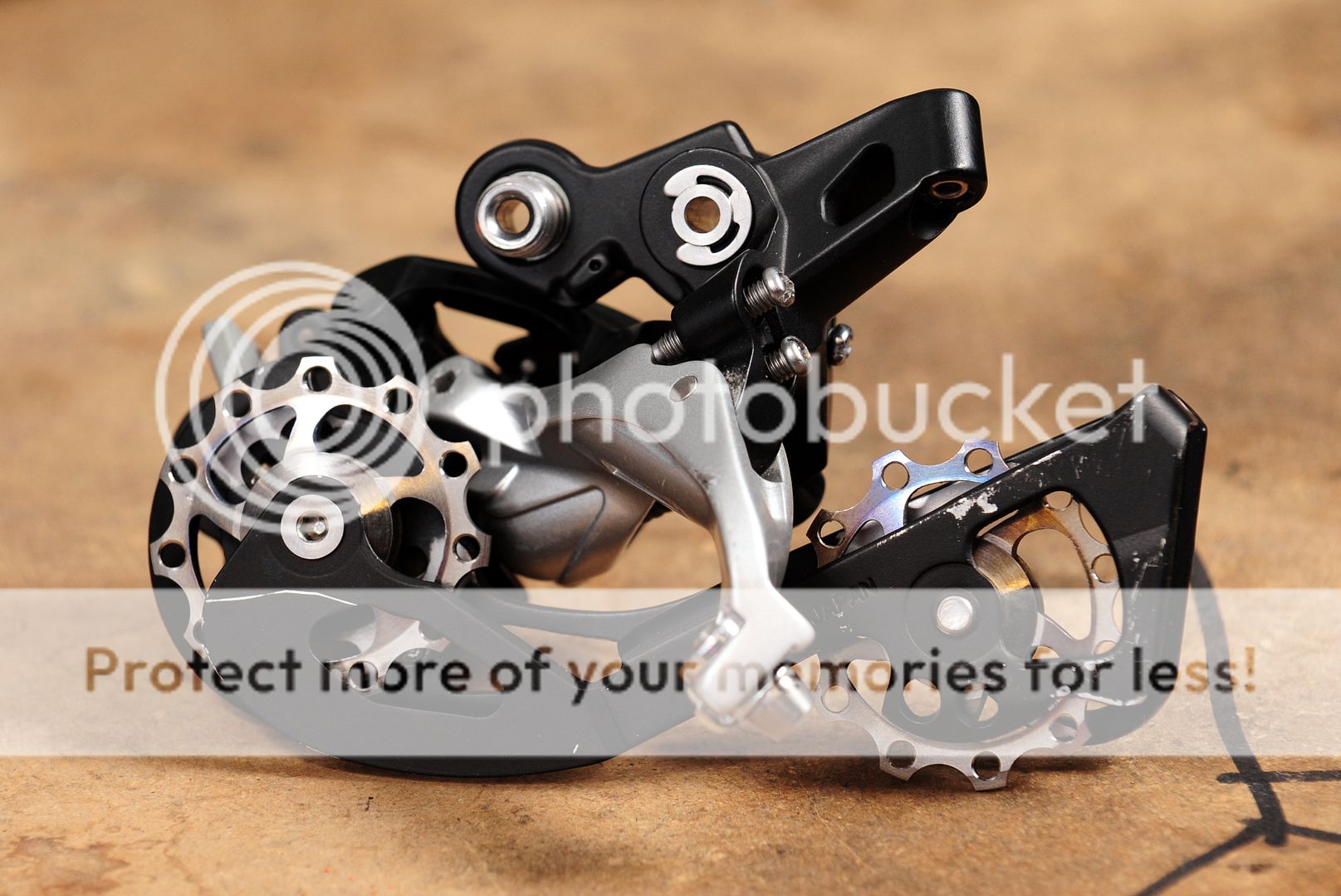

Two other little jobs I performed today, I reassembled the rear mech, but added the titanium jockey wheels I sourced from eBay.
I did have blue Hope ones before, but they had to go.

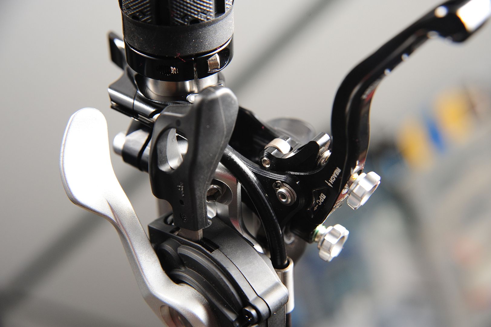

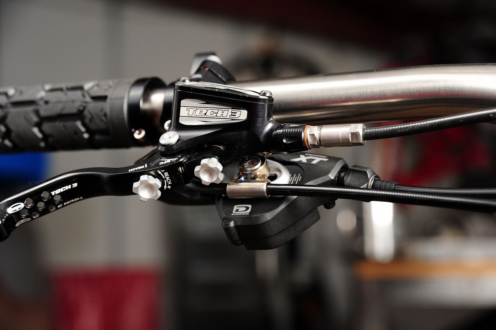

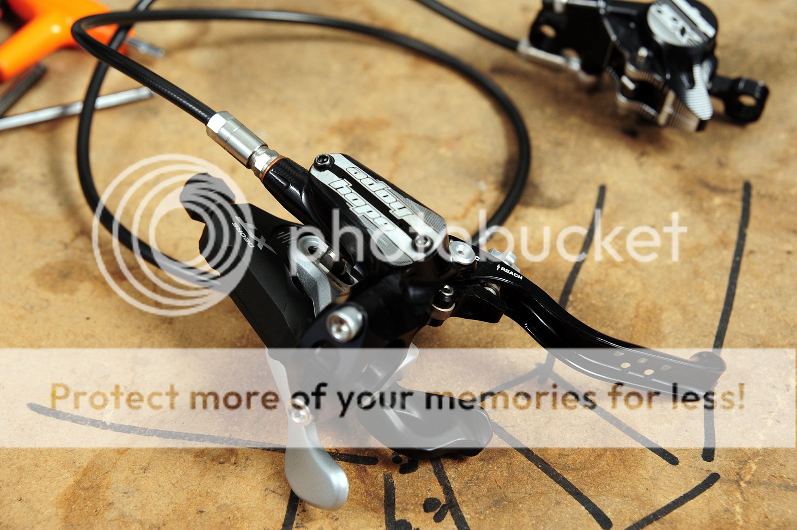

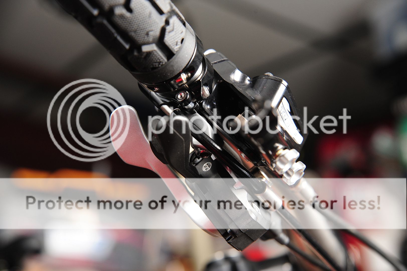

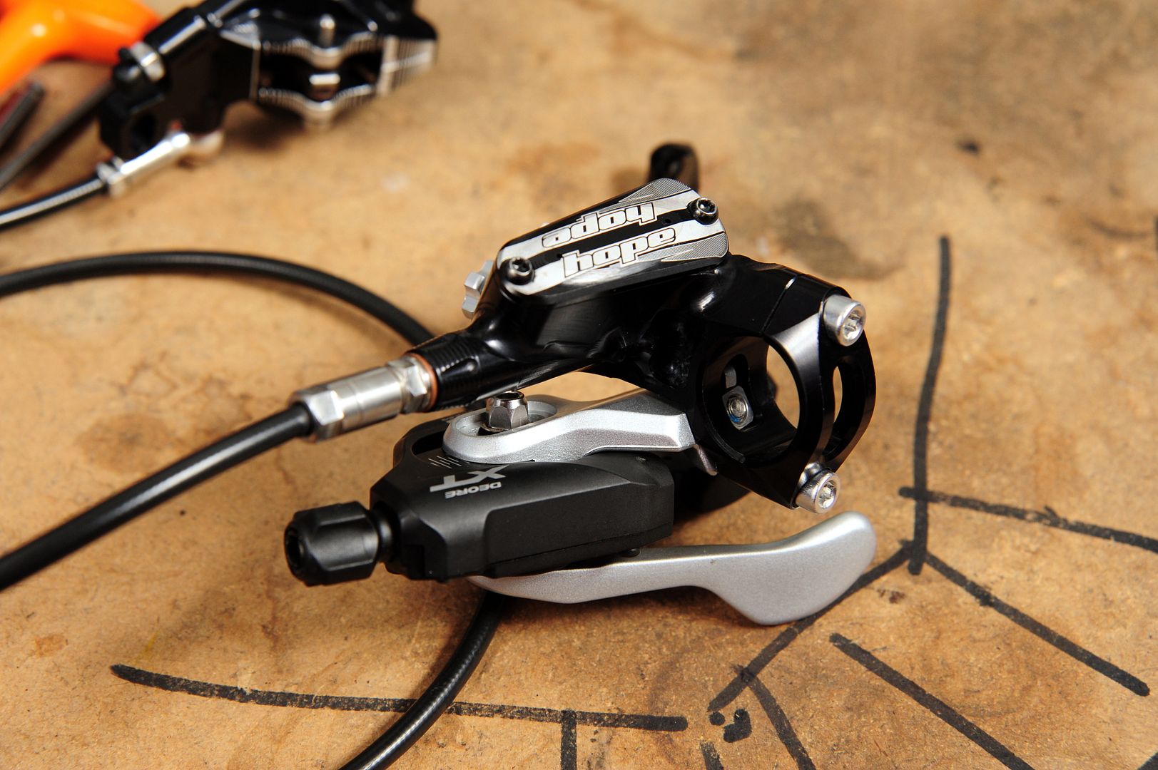

And I assembled the XT shifter pods onto the Hope tech3 levers. I'm so impressed with the design if this little setup, It's so slick.
