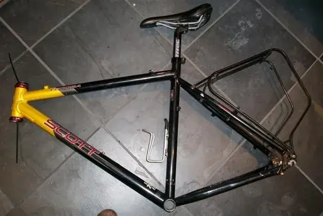

Name that frame...
Another pic..... definitely sure it's a Scott :)
Even showing the yellow this time.. :wink:

nice detective work Steve... but I have more questions!!!
1) is it worth doing anything with? IE was it a high-end bike originally?
2) what vintage is it? What parts did it originally come with?
3) did it come with sus forks or rigid?

1) It wasn't a high-ender, but it IS a well made (and strong) 7005 series Alu frame, so will take a good deal of abuse.
2) It's a 1999/2000 Model Year
3) yes it came with SUS forks, but unsure which at the moment.... :wink:
I'm currently building one as a basic hack bike to abuse throught the winter, I'm confident with a few nice components it'll be a winner :wink: :wink:
If you need any help with yours, give me a shout.. :wink: 8)

Hi,
It's definitely Scott frame - but not necessarily Yecora
From 1998 (first alu frames in sport series as GT-Steve's Yecora) to 2001 all frames from Sport series had same design
In 1998 and 1999 it was same frame for all models (Boulder/Vail/Tampico/Yecora - 7005 T4/T6 PG Tubing)
In 2000 Boulder had Double Butted Tubes, Vail/Tampico/Yecora still PG Tubes
In 2001 Boulder - DB Tubes, Yecora/Tampico PG Tubes (and Performance Series signatures)
In 2002/2003 Boulder had new dropouts, but Yecora/Tampico had same frames as in 2001
Frames was always equipped with suspension forks (fex RS Jett, Manitou Magnum)
I can search geometry of this frame if You want
Also - do You know what stuff was mounted on it?
