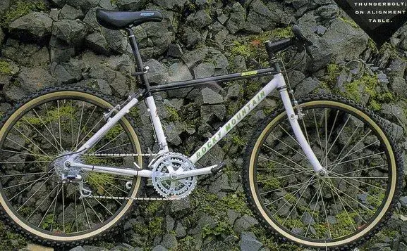

Sod the edit on my way to the loo 1993 RM Blizzard was black/white, filled in dropout (as they did in '93), very sloping, short wishbone top...
I meant 1992 there, same year as my Fusion.
Your Seatpost will more than likely be 27.0

Yep RM was my first guess, just needed to check the model, and does look a 93.
Though they did use the long extension on earlier frames too, which threw me a bit.
Very nice frame. Too good for the missus ;)

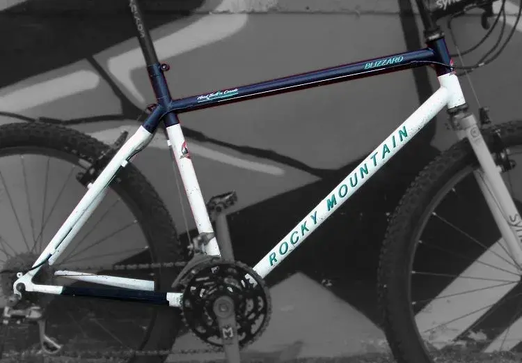

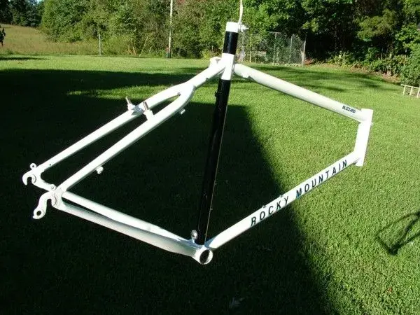

I'm not sure how you're telling it's a 92 and not a 91 without the paint. It clearly isn't a 90, as the 90 had a rear U-brake. I haven't got a pic of a 92 seat tube, but it could be that the pulley to allow a BP FM (see below) is only on the 91.
Edit - I now see your frame has no pulley, so could well be 92 - was that how you told the difference?

Incidentally, if it is a Blizzard, it will have Tange Prestige Concept tubes, which are notable for (a) the top tube and the down tube are the same thickness, (b) both are ovalised, (c) both are tapered, 3.0 x 2.7 cm at the rear to 3.4 x 3.0 cm at the front.
I don't think any other tubeset had those dimensions.
The 1991 Blizzard frame is similar in style to my 1991 Altitude, 1992 has a lot of changes.
1) Dropouts
1991 had holes in them, 1992 did not.
2) Front Mech 'noodle'
1991 has a routing noodle from top tube to seattube, 1992 does not.
3) Front gear and brake guide stops.
1991 they are on the Headtube, 1992 they moved them to the top tube.
Any more differences you need ?
is the seat tube Prestige tubing as well? i can't get either the 26.8 or 27.2 seatpost down to even close to the upper watercage bolt area.
