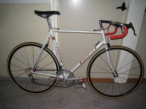

Speedstream
I always had a weakness for early eighties 'aero' bikes and I unexpectedly stumbled upon something I'd been looking for a couple of years. A Gazelle Speedstream, one of only about 25 made. It had been taken excellent care of and it wears the same colours as in the 1984 brochure!
It offers the ideal base for the Modolo Kronos brakes since the rear brake bridge supports the flipped attachment of the rear Kronos brake. Wheels are early eighties french Roval's (prior to becoming a Specialized label) and the handlebars are flattened 3ttt aero from the same era.

and the wheels are really so elegant 8) - french top stuff - the hubs are the sleekest of the era 8) 8) 8)

Thanks. I am really pleased with the frame and groupset. Pre-dating the Mavic Helium - often regarded as the first factory prebuild wheelset - by more than a decade, the low spoke-count, straight-pull wheels are really astonishing. The frame is one of those jewels you don't find every day (or year, for that matter).
