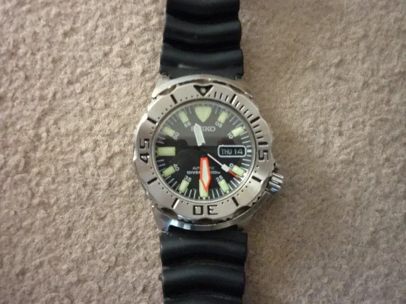

my seiko monster watch...

:shock: mines just died... :? going to a local guy today..let you know..

it just died on me......aaararrrrggghhhh
the second hand stops going round after a few minutes.....
first time ive ever had an automatic go wrong .... :(
Orange Monster?
Maybe you could have it serviced - although often the just replace the movement. With some places it's fixed price.
7S26s are normally pretty robust - not necessarily the last word in accuracy, but normally pretty bombproof.

gibbleking":flhu4pgi said:
i had another message this morning,,they have offered to do it for 68 spuds all in as a sign of good faith......
Bite their hand off at that price.

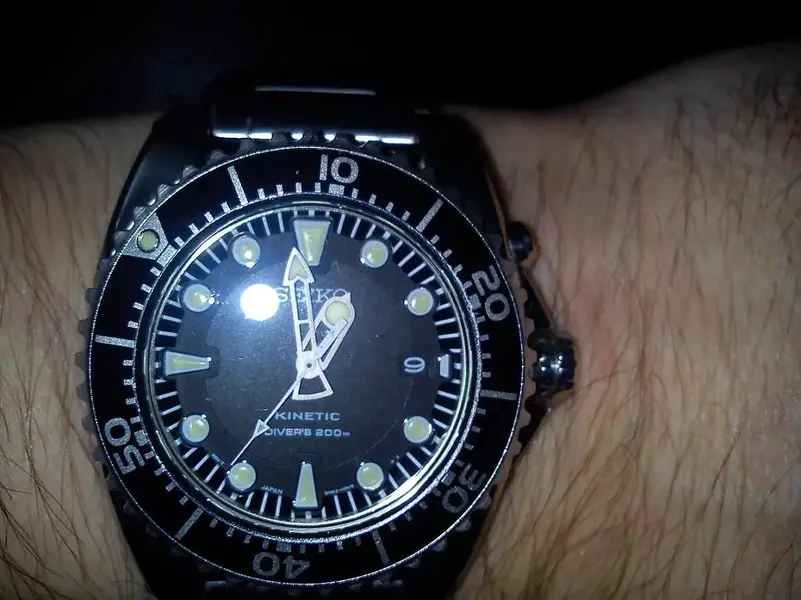

i may just put the thing on ebay and get a classic one thats a few years older...i do have this as my emergancy back up watch..

just got mine fixed..this is how the watch tech explained what happened.. ""hairspring got caught on a moving part the moves 6 times a second..you must have banged that watch when the movement was moving out..this gets caught in the spring and stops""..
I have used this guy before..he wouldnt take any money..but i will know where to go for a priced watch repair :wink: :wink:
Ernie 8)
Sounds like you've got a good local watch guy who knows his stuff - very handy.
Had that been the usual suspects on the high street, they'd have likely sent it off, for at least the cost of Gibble's "good faith" offer.
