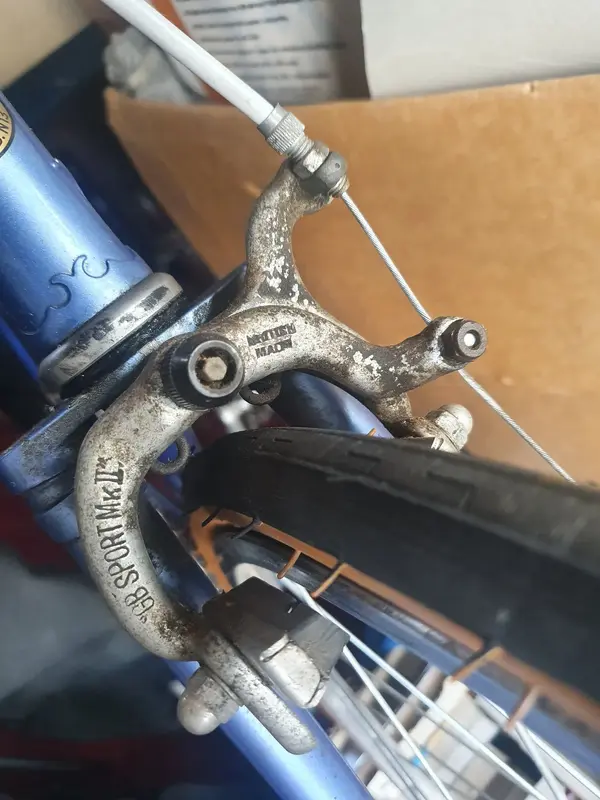

That's a very close clearance rear brake bridge for an early sixties road frame, or even a road/path frame- it might've been repositioned at some time ? or it could've started out as a track frame. I don't know if those wheels are 700c or 27" ? Those brakes look to be Weinmann 500s and the blocks are right at the top of the stirrups. I don't know if anyone would've been building like that in the early sixties? Maybe. Iirc, Harry Quinn was doing close clearance/short wheelbase TT frames some years before their seventies heyday..

It has Weinmann concave 27" on it. Not sure on the brakes, I'll take a look. I guess it will take 700c without a problem. Tubulars were always 700c?

Yes that's the point. As far as I'm aware, prior to Campag Record brakes in the late sixties, most brakesets had a longer reach brake at the rear, and most road going frames would have been built to accommodate it. A road/path frame would usually have been expected to be able to accommodate mudguards too. Your frame has the mudguard eyes, but lacks the bridge/crown clearances you'd expect to accompany them, so it could be either a road geometry/clearances ten+ years ahead of its time, or a track frame modified for road use ten+ years after it was first built.

Here are some photos of the brakes. I know nothing about their age.
